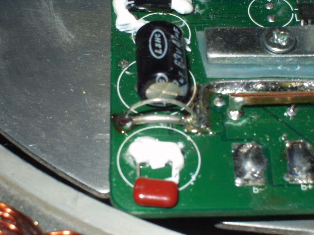

Monkey, I put the additional loop directly across the existing shunt on one controller, as you can see in this photo:
The other controller had the shunt hidden underneath the circuit board, so I simply scraped clean a small area of copper on the circuit board and soldered the additional shunt there instead. (see attachments)
I was aiming for a total of around 50Amps from both controllers, so I figured that as the thick shunt was allowing 20Amps, an additional thin wire (the leg of an LED just seemed to be a good choice) would hopefully produce an extra 5Amps or so on each controller.
My highest wattage before any modifications was 1073Watts, and with the shunts fitted I managed 1340Watts, pretty much the 25% increase I was hoping for (I'm now convinced that I was only getting power from one controller and not both).
When I removed the failed controller (see attachment), I also removed the additional shunt and soldered this onto the working controller in addition to the extra shunt I had already fitted. These two thin shunts were spaced approx 1mm apart and I decided to fill the gap between them with solder to greatly increase their cross sectional area and lower their resistance for more power! ;D
(Sorry Monkey, I didn't take a photo of the fattened up shunt)
This is why I'm now getting such a large increase in the maximum current draw, 58.6Amps compared to my previously highest recorded figure of 20.66Amps before the shunt mod.
I'm wondering whether the current draw would be different if the hall sensors were working. If my controller can survive long enough, I may eventually find out. ;)
