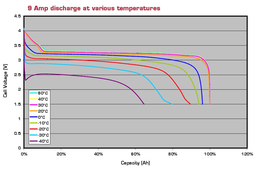

I found this graph for a Saft 44Ah 3.3V LiFePO4 cell:
Although the capacity is reduced at lower temperatures, it still manages to supply 90% of its rated capacity at -20°C, but it's only supplying current at around 0.2C throughout the test.
This would be equivalent to the GM pack continuously supplying just 2.05 Amps from full to empty.
As you will have obviously be draining your battery at a much higher rate, the consumed capacity is likely to be a lot less than the above graph.

I have used my e-bike during winter for several years, and even at 0deg. C. the capacity are noticeable reduced compared to 15-20deg. C. At -10deg. C., i'm guessing the capacity are reduced to around 60-70%.
At temperatures below freezing, I seldom do long rides; only a couple of miles at a times, and I have to charge more often.
I'd agree with Alan; That graph would not be valid when discharging the battery at higher rates. Also, the battery's capability to deliver the rated continous C will also be reduced below freezing.
