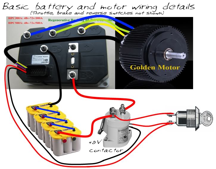

« Reply #7 on: September 18, 2010, 02:50:04 PM »
OK to make things more simple is this correct?
The wiring for the batteries is wrong, you have shown them wired in parallel which would only give 12V, and you have managed to connect them directly across the fuse. ???
It should look more like this:
More information regarding the wiring of the older multiplug can be found here.
EDIT: This controller now uses a 23 Pin connector instead of the 14 pin connector as on the HPC100B. I will try and provide some details to suit. See post below
In the above diagram, I have just shown a 48V contactor (heavy duty relay) being used to disconnect the power to the controller, but I would also suggest fitting a manual isolator switch similar to this:
The isolator switch must be capable of safely carrying the maximum current and should be fitted into the positive battery cable (as well as the contactor) just to play safe.
Several sprockets with 7/8" diameter holes suitable for this motor can be found here.
Hope this information helps.

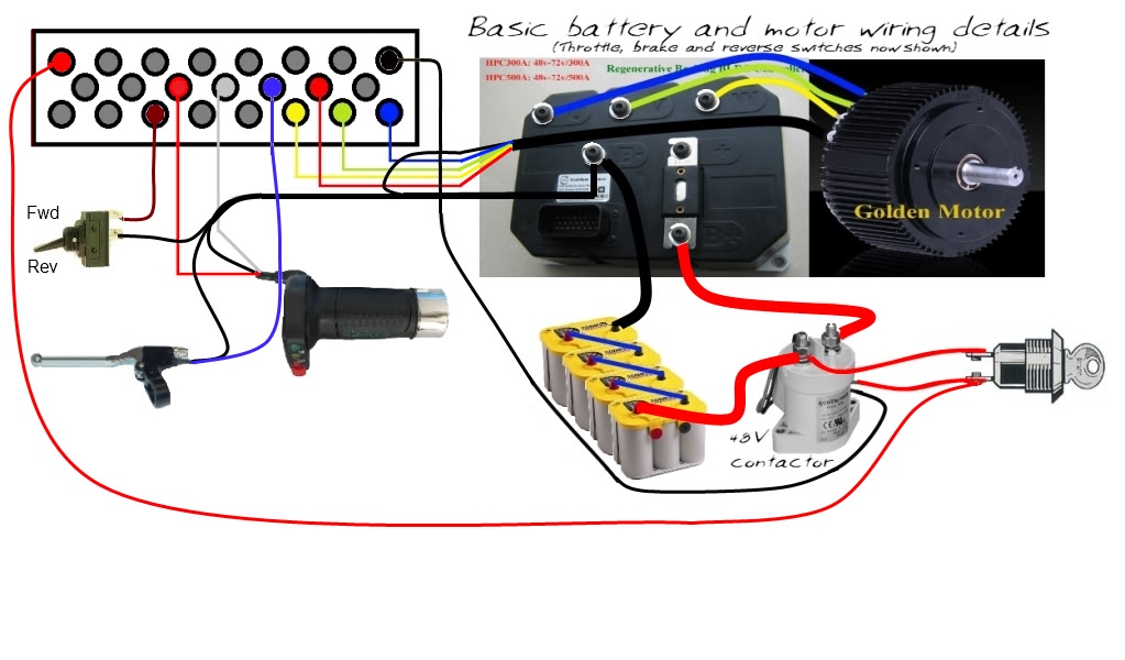

OK is this correct?
Those 2 holes confuse me a little bit in the middle
one is to a brake and the other is for forward and reverse. Why I am confused about it is that there is just one pin for each, wouldn't there be a + and - for each.

OK is this correct?
If I'd looked closer at the photo in the first place I would have realised the multiplug was different to the old controller. Even though it has 23 pins instead of the old 14 pin version, the -ve ground wires from the throttle, brake switch, reverse switch and hall sensors do not appear to connect through any of the multiplug pins, so they would need to be connected directly to the B- connection instead.
Hopefully this updated explanation of the HPC300A/500A controller connections will help:
Ref. Page 2 of the User guide.

23 Pin Plug connections
  Pin  1    Controller Power on (& Contactor coil energised) (Red) +ve feed from key switch
  Pin  2    Not used
  Pin  3    Not used
  Pin  4    Not used
  Pin  5    Not used
  Pin  6    Not used
  Pin  7    Not used
  Pin  8    Contactor coil negative wire
  Pin  9    Not used
  Pin 10   Not used
  Pin 11   Throttle Control 5V supply (Red)
  Pin 12   Throttle Control Signal Wire (White?)
  Pin 13   To Ground via Brake Switch
  Pin 14   Motor Hall Sensor 5V Supply Wire (Thin Red)
  Pin 15   Not used
  Pin 16   Not used
  Pin 17   Not used
  Pin 18   To Ground via Fwd/Rev Switch
  Pin 19   Not used
  Pin 20   Not used
  Pin 21   Motor Hall Sensor Wire (Thin Yellow)
  Pin 22   Motor Hall Sensor Wire (Thin Green)
  Pin 23   Motor Hall Sensor Wire (Thin Blue)
Throttle, Brake switch, reverse switch and Motor Hall Sensor Black leads must be grounded to B-.
Pin layout (As viewed from the cable side of the plug)
    (1)   (2)    (3)   (4)    (5)    (6)    (7)    (8)
      (9)   (10)   (11)  (12)  (13)  (14)  (15)
   (16)  (17)
  (18)  (19)  (20)  (21)  (22)   (23)
Plug Part No: 770680-1
Click Here for more details.
I think these details are correct now.

So if my calculations are correct then this pic I mocked up is flawless?
PS if you hold CTRL and use the scroll wheel on your mouse at the same time you can zoom in
« Last Edit: September 19, 2010, 01:10:18 AM by Troopermanaic@yahoo.com »
Re: Almost there
« Reply #13 on: September 19, 2010, 01:25:25 AM »
But still not quite flawless. ;)
It should be a bit more like this:
Click to enlarge
