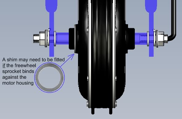

Wheel was spinning nicely until the free wheel (6 speed gear tightened up).Binding soon ensued. I think it need the shim(washer?). Where does it go?
Scott,
The shim needs to be fitted between the freewheel and the hub.
