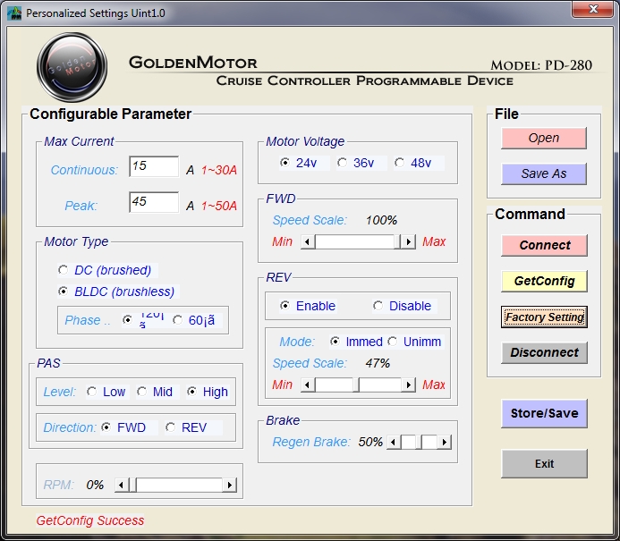

Seems that my current limits were too low, there is some sampling mechanism in the controller probably that checks every now and then, if the current has been too high for some time.
Then it just turns the wheel off.
I had 15A nominal max and 40A peak and 48V.
Now I have set 25A as nominal max and 70A as peak as in factory settings.
It helped but I'm not sure why. My settings were ok until now.
One thing could be that LiFePO4 battery is starting to give out it's full potential after couple of chargings, and currents just went overboard.
For 400W, there shouldn't be such high current though. But peaks were ~650W... Maybe 15A was just too little. if the voltages temporarily decrease, the motor draws more.
Still sounds funny.
Let's still take a brake and see how things go.

« Reply #6 on: October 19, 2012, 12:25:07 AM »
Try setting it back to the default parameters, my Smart Pie came factory set as follows:
I'm wondering whether the controller might be cutting out a bit too soon on the 48V setting, in which case it might be worth resetting the Motor Voltage setting to 24V to ensure that the controller's Low Voltage Cut-off will not activate before the battery's.
I have my controllers set to 24V on all three of my Magic Pies and also on the new Smart Pie, and I regularly use different voltage batteries (25.9V, 29.6V and 51.8V LiPo packs) without any problems.
« Last Edit: July 04, 2017, 07:59:27 PM by Bikemad »

Wheel rolled very well on my test bench, no cuts. But in the bike it now cuts noticeably quicker. So it's probably getting too much already. The leds in the handle burn much brighter also :)
Thanks for the tip. That actually was the setting with delivery (24V). I changed it to 48V.

With 24V setting (and others as above), the problem persists. The motor runs smooth now for 2-5 s after startup. If I power off/power on, nothing.
If I leave power off for 5-10min, then again 2-5s it works.
