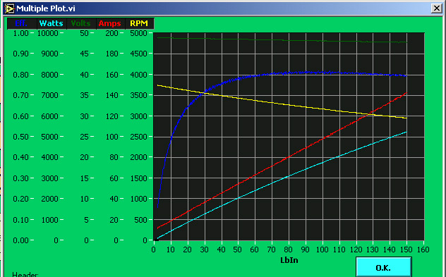

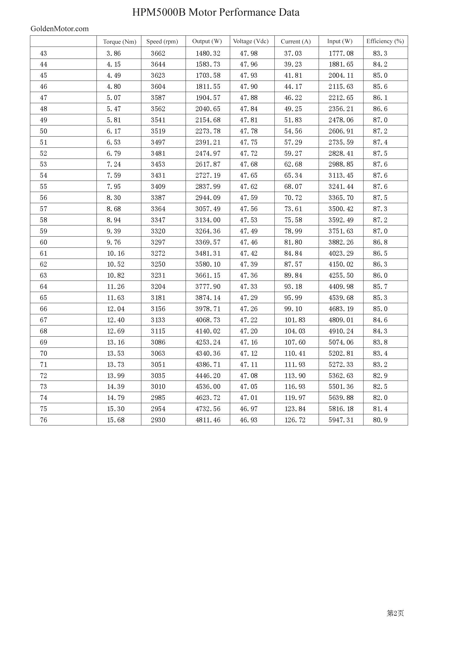

The Performance curve and Performance Data only show the results for the HPM5000B motor being tested on a dynomometer @ 48V.
A typical 48V battery pack would have a slightly higher voltage and should produce an unload speed of at least 4000rpm instead of the ~3750rpm indicated on the performance curve, which was probably obtained by using a fixed ~48V power supply instead of a battery.
