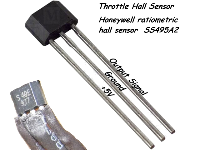

Hello Alan,
Today I opene'd throttle switch and I measure'd black and white cable which are going in to hall sensor it is 5v. When I change the magnet position it is giving constant 5v reading.
Is it suposed to be 0 and when I change the position of magnet to be change'd?
Regards
  • Posts: 5,645
Re: MPIII Throttle hall sensor wiring
« Reply #6 on: June 22, 2013, 10:40:29 PM »
Hi Dino, I cant remember for sure what colour wires are used inside the MPIII throttle but there are three wires connected directly to the hall sensor which I'm pretty sure were coloured:
  • White: +5V power supply
  • Black: 0V ground connection
  • Green: throttle signal output (should vary between ~0.8V and ~4.5V when the throttle is operated)
On the earlier Magic Pies the colours were:
  • Red: +5V power supply
  • Green or White: throttle signal output (should vary between ~0.8V and ~4.5V when the throttle is operated)
Here are the pin connections on the hall sensor:
If you check the voltage on the Output Signal pin it should vary as the magnet is moved (or remain at a steady ~2.5V if the magnet has been removed completely).
« Last Edit: July 04, 2017, 10:15:44 PM by Bikemad »
