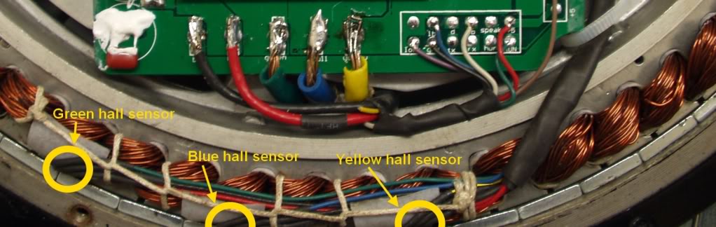

All GM examples I've seen on the net the yellow phase wire is always in the centre of line both on the hall sensors and the phase wires.
Green pulls in one direction and Blue the other direction so yellow is the follower to either direction.
So My suggestion is to change blue and green on the phase and on the halls and leave yellow connected to yellow.
The question related to the Magic Pie, and mine is wired like this:
If you click the image to enlarge it, the colours of the hall sensor wires are more obvious.
(I did have to highlight the yellow one because it was a bit camera shy)
This is why I originally suggested swapping the Green and Yellow leads:
Have you tried connecting the Reverse connection to ground (0V) on the controller? This may select reverse if it's still enabled on the Pie's controller.
If you're going to swap phase wires instead, I would start by swapping the green and yellow phase wires first, but you will also need to swap the green and yellow hall sensor wires as well!

SO I presume that the GM HBS motors and the Pie with its internal controllers are obviously not the same.  Does this apply to any Magic controller too with my and half the other GM hubs out there, Mine both were the same, yellow wire in the middle.
Actually this pie has been the first GM hub I've seen with the yellow on the outside, but my eyes don't see everything.
I don't doubt you BM, you're advice is usually very accurate when concerning GM products,  Once I saw some order and now am seeing chaos considering the GM phase and hall wire colour standards.
Will I have to mess around with the hall and phase wires?  Things may of changed, oh well.
