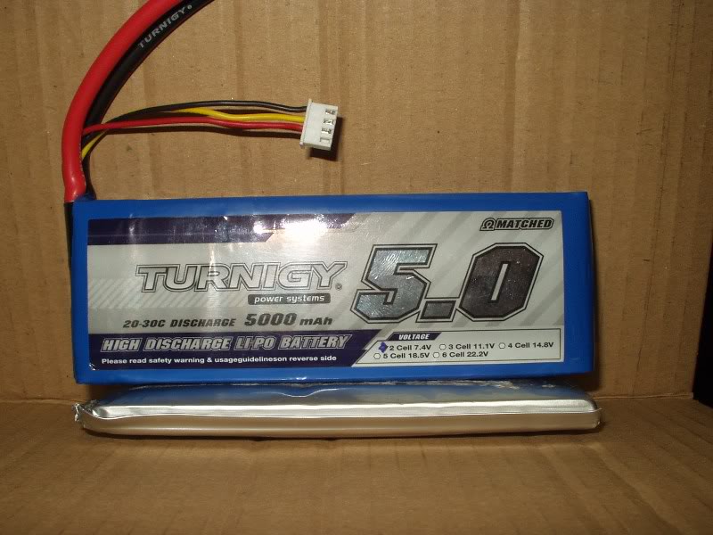

« Reply #17 on: March 19, 2010, 02:07:14 AM »
I've already had one cell die on me after trying some similar tests earlier today, but fortunately it didn't catch fire or explode!
Two of the three Cells are still reading 4.1V, but the other ballooned cell is only reading 0.04V! :(
I'm not very happy about this failure as the pack is only two months old, and this was the first time I had used it!
I think I'll just pull it apart and convert it into a 7.4V pack for my son's R/C car instead.

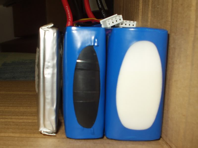

Mission accomplished
I made up an adapter so that I could use the discharge function of my charger (through the balance lead) to drain the good cells to just over 3 Volts each, so it would be less likely to catch fire or explode while dismantling.
By carefully trimming the end of the heatshrink wrapping, I managed to persuade it to slide off, so I could re-shrink it back onto the much thinner pack after the faulty cell had been removed, and here is the end result:
Above is the converted pack, with the swollen faulty cell on the left and a normal 3 cell pack on the right for comparison.
The faulty cell had ballooned to almost twice the original thickness.
My IMAX B8 LiPro balance charger is supposed to charge 1 to 8 lithium cells, but for some unexplained reason, it doesn't have a 3 pin balance socket suitable for a two cell pack. ???
So I've kept the four pin balance plug and simply rearranged the three leads and it works fine.
I'm all for recycling whenever possible, and this battery was no exception, I now have a good two cell pack that I can use, which has got to be better than a faulty three cell pack that I couldn't. ;D
