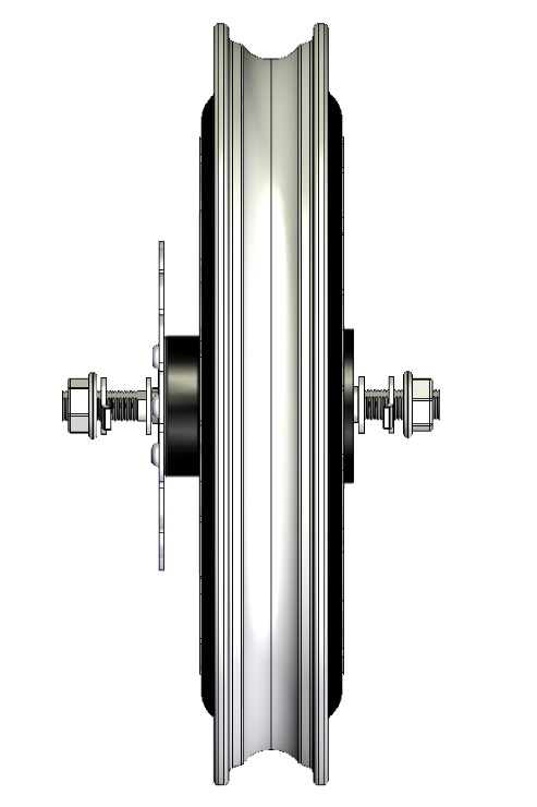

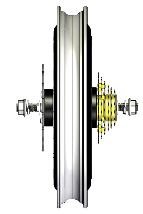

Re: Offset Rims?
« Reply #22 on: January 24, 2010, 01:37:37 AM »
Discuss this... and don't say I don't care for my beloved forumers. ;)
I think that the 16" cast alloy rim looks really nice, but I was surprised to find out that it still suffers from the offset rim problem.
(About 7mm offset on the front and around 9mm on the rear.)
This could easily have been sorted if the rim had been offset to allow for the offset hub as shown in the attached diagrams below.
I realise it may not be cost effective to produce two different rims for the same size wheel, but if it had been designed with an offset  7mm, it could be used either way round to suit front or rear wheels.
This would have given a perfectly centred front rim, and a much reduced rear offset of 2mm instead of 9mm, which would be a lot easier to accept.
A front rim which is not correctly centred will have a noticeable affect on the steering, it will pull to the left under acceleration, and pull to the right during braking and I expect it will also upset the self centring castor action as well.
It should be relatively easy to incorporate the correct amount of offset into both the design and the manufacturing of a cast rim.
I would love to hear your comments on the subject of offset rims.
« Last Edit: June 30, 2017, 06:07:23 PM by Bikemad »
Offline GoldenMotor
  • GoldenMotor
  • Emperor
  • Posts: 10,040
  • Dark Templar
    • GoldenMotor Youtube
Re: Who wants Smaller Pies?
« Reply #23 on: January 24, 2010, 07:13:37 AM »
Dear Alan,
We are going to create moulds for 20" cast rim for MagicPie since 20" rim is most popular for teenage bikes. We will adopt your suggestions to make 20" rim more centered.
But we like your and other bike riders advices on tire sizes for this 20" MagicPie. It is expensive to make new mould. So we want more feedbacks on 20" to mount most common available tires.
Thanks for your support.
Golden Motor

Re: Suggested solution to cure offset rims
« Reply #26 on: January 25, 2010, 01:36:10 AM »
I don't know how feasible this idea will be, but here goes anyway:
I propose an adapter ring could be cast out of lightweight alloy to enable the existing hubs to be adapted to enable all spoked wheels to have their rims centred correctly.
First, One of the spoke fixing flanges would need to be machined off the existing hub.
Then the cast adapter ring could be bolted on top of the side cover using longer bolts to secure both parts in one go.
This would effectively reposition the spoke flange so that they were both approximately centred within the axle fixings rather than being centred on an offset hub.
Front and rear hubs would need the adapter to be fitted on different sides, but it should be possible to use the same adapter for both front and rear wheels as the spokes should be able to compensate for the slight differences.
The assembly could then be repainted as required to blend in the machined surface and the newly fitted adapter ring etc. prior to the assembly of the wheel, which could then be built with the rim perfectly centred. (and hopefully concentric as well ;))
This modification would mean that only one side cover could be removed easily for access to the motor and controller if required, but I don't see that would be a real problem.
I've tried to show exactly what I mean with the following animation:
it would be nice to know what the guys at GM think to my suggestion. :)
« Last Edit: January 25, 2010, 01:37:41 AM by Bikemad »
Offline GM Brazil
  • Posts: 275
« Reply #27 on: January 25, 2010, 02:09:05 AM »
Alan!
You take this out of my mind! I swear I have it drawn in a notebook!
But I see it as a (good, but) temporary solution, for long therm they need to have a new design for this component.
« Last Edit: January 25, 2010, 02:13:41 AM by Yacamim »

Offline Jazzjerry
  • Posts: 130
  • Carpe Noctum
    • Beeldhout
« Reply #29 on: January 25, 2010, 08:30:59 AM »
I definetly agree with Alan that something should be done about the off centre wheel.
The Idear and animation looks very good, to fix the current pies.
The next phase however would be to learn from this first pie and alter the fabrication proces.
Would be a shame to pruduce such a nice motor with some minor design flaws in big numbers.
Best regards,
Jerry.
