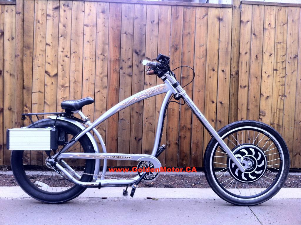

Is the lower arm always horizontal?
Chainstays typically slope downwards slightly towards the bottom bracket:
But here are a couple of exceptions:
The angle between the seat stays and the chainstays can also vary significantly on non-suspension frames.
