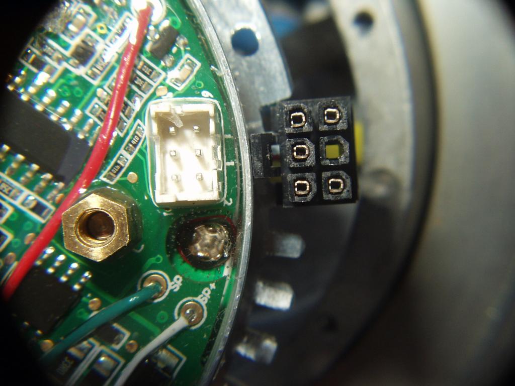

The three Hall sensors each have three thin wires and are located just below the magnets at the top of the stator in this picture:

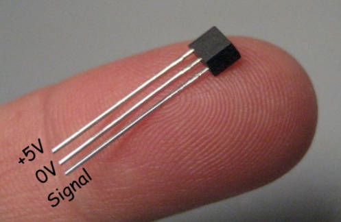

This is what the Hall sensors look like:
If one of these Hall sensor was to fail I would expect it to cause the motor to stop running completely, as the MP5 controllers I've tested do not appear to have a sensorless mode.

If you can't find anything obvious with the external wiring, it might be worth removing the controller to check that the Hall sensor connector contacts are all fully inserted into the 6 pin connector plug and none have been pushed out of the connector causing a poor/intermittent contact.
