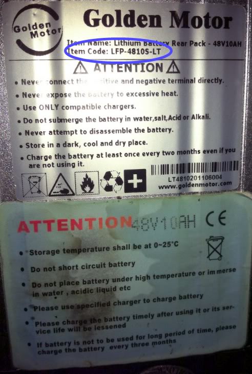

The battery you have is uses 4Ah 26650 Lithium Manganese cells not LiFePO4.
Each group of three cells should be charged up to 4.2V where balancing takes place, hence the 54V measured charger output (13 x 4.2V = 54.6V).
LiFePO4 only charge to 3.65V per cell.
This battery must be quite old as GM superseded them with the 48V10Ah LiFePO4 packs over 8 years ago. ::)
The newer 48V packs are labelled LFP-4810S-LT as shown here:
I suspect that the cells have deteriorated over this time (especially if they have been powering dual Pies) and this has caused the failure of the BMS resistor.
You could try replacing it with another 100 Ohm resistor but I don't know how successful that will be.  :-\
I'm guessing it will be a 3 Watt resistor, but it might be smaller, so check the physical size and see if it matches the one in the link above.
