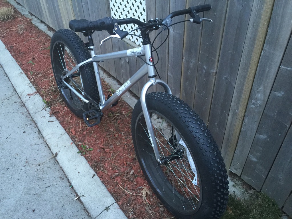

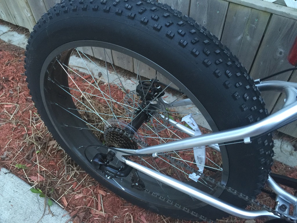

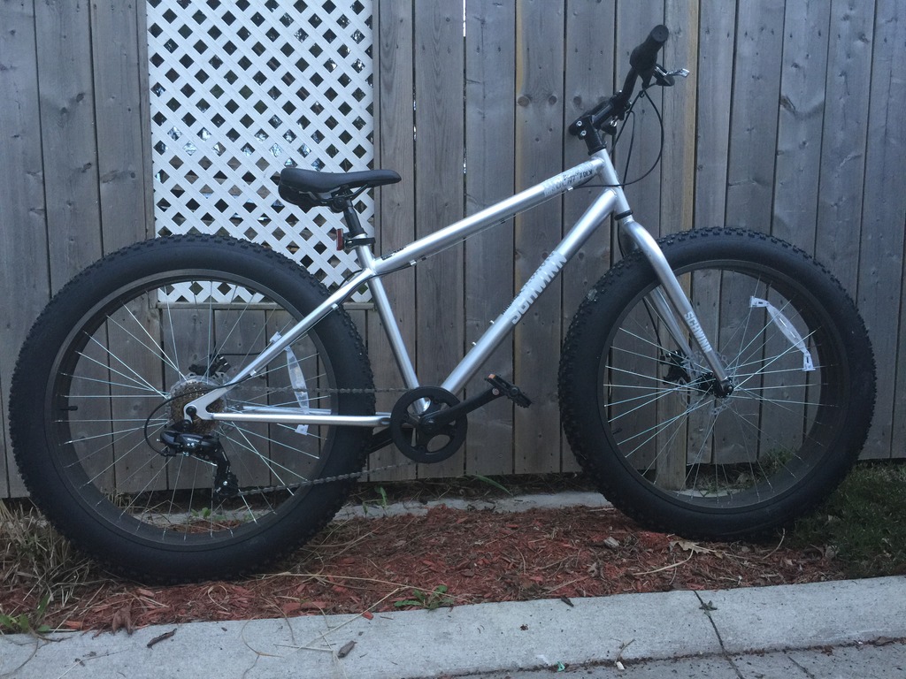

Next Project!
Monstrous 26x4 tires
This will be a front wheel drive
Just have to find the time :)
