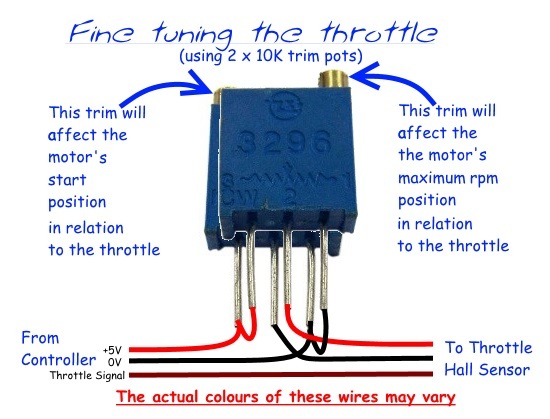

It should be possible to fine tune the throttle using the following modification:
Click here for more details.
But if your +5V output is already too low to achieve full throttle (3.25V output signal) the additional 5k Ohms load (2 x 10k Ohms resistors in parallel) could possibly pull the +5V supply down slightly and decrease the maximum rpm even further.  ::)
