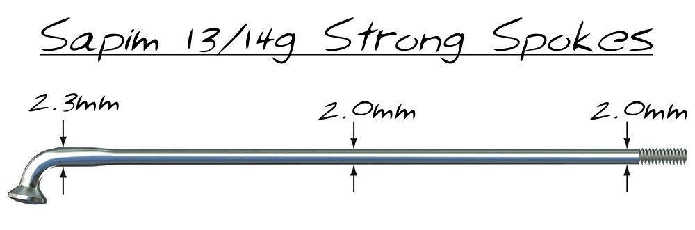

I would suggest that you use 13/14g Sapim Strong butted spokes if possible:

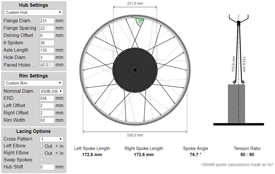

« Reply #4 on: June 29, 2017, 11:46:48 PM »
I can't use that hub spoke calculator because it doesn't have 27.5 inch rims as an option.
You would need to enter custom measurements for both the rim and the MP Edge hub into the ebikes.ca spoke calculator to determine the length of the spokes.
Select "Custom Rim" from the dropdown menu in the Rim Settings section and then select "650B (584)" from the Nominal Diameter.
(650B is just another name for a 27.5" rim and therefore has the same 584mm bead seat diameter)
If you know the ERD for your particular rim you can simply enter the correct measurement, otherwise you will need to measure the ERD before you can enter it.  ;)
My MP Edge has a "Flange Diameter" of ~231 mm with a "Flange Spacing" of 22 mm.
The above screenshot shows the results obtained using the measurements for the carbon rim mentioned in my previous post, and shows that this particular rim would require 173 mm long spokes to assemble it onto a MP Edge hub.
