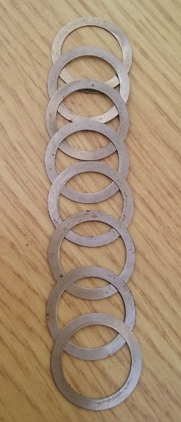

My Magic Pie Edge had several flat steel shims instead of the wavey washers to take out the movement in the bearings:
If your bearings are still smooth and quiet, adding some additional shims should eliminate any unwanted movement in the bearings.
If you can't find spacer shims of the correct size, you could apply some aluminium tape to one (or more) of the existing shims to thicken them up and simply trim around the inner and outer edges of the shims with a sharp modelling knife to remove the surplus tape.

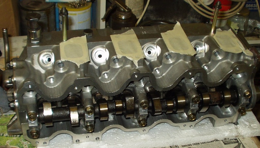

I have successfully used this method to produce thicker shims for setting valve clearances on my Toyota's new cylinder head, and it added ~0.006" in thickness for each layer of tape.
The aluminium tape was basically sandwiched between the shim and the bucket to ensure that it would not be worn away by the hardened steel camshaft.  ;)
The engine ran great for two years until the replacement cambelt (the one that was supplied with the new cylinder head) decided to snap, bending some valves, and breaking the camshaft into four pieces. This resulted in the destruction of a perfectly good cylinder head. :'(
