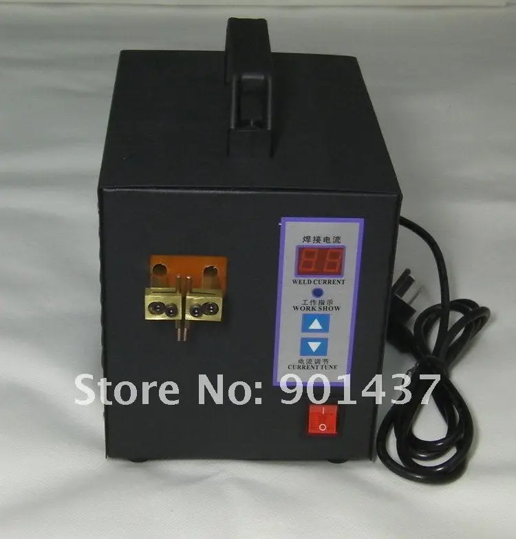

There are plenty of spot welders available from AliExpress and on eBay, many of which will run off 240V like this one:
Unfortunately, these are likely to cost a lot more than your DIY spot welder.

Yeah - I've looked at these...
The ones with the fixed probes wouldn't reach into the middle rows of a triangle pack.
The only one I can find with hand held probes requires an RCB above 60A. I've read quite a few reviews from people that have been unable to use it with a domestic supply:
As for being more expensive... That would depend on how much one has spent on replacement bits and car batteries and the like ::)...
I don't think I'd be too far off the price of a Chinese welder if i'd kept a count.
