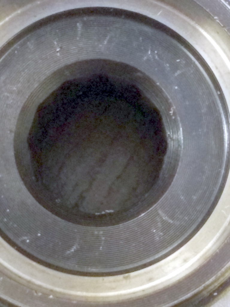

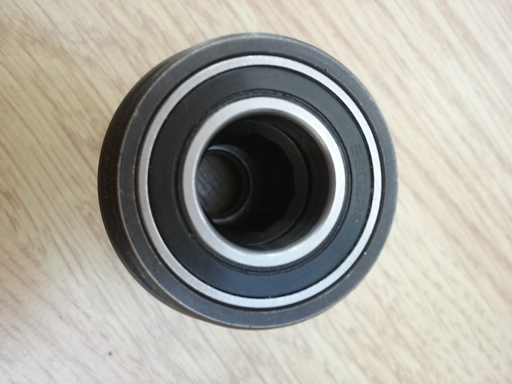

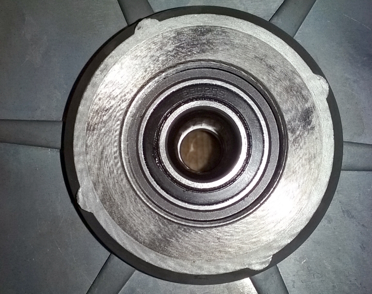

I am a new owner of a Magic Pie Edge and (with the benefit of hindsight) made a big error by placing a home-made tubular spacer in my 8 speed cassette in an attempt to centre it in the frame (rather than using the inner nut on the axle, which seems to push it off-centre). It worked perfectly for a few weeks, then it started to click and crunch, and the result is a mangled the bearing cartridge inside the freehub. Hopefully the attached photos will show what I'm talking about.
So, my question is: how do I replace this? Is it a standard bearing set that I can buy from a bike shop, or do I need to order a new one from Golden Motor? Or do I need to replace the whole freehub unit??
Any advice would be much appreciated!
Ben

Hi Ben,
You should be able to replace just the inner and outer bearings on the freehub assembly.
The outer bearing on mine is a 6901Z (Z=metal shielded bearing) and the inner bearing is a 6902RS (RS= Rubber Seal) but I would be tempted to use a 6901 2RS on the outer bearing to help keep water and fine grit out of the bearing.
The bearings are readily available on eBay and here are the links:
  • 6902 2RS 15mm x 28mm x 7mm inner bearing with 2 rubber seals
  • 6901 2RS 12mm x 24mm x 6mm outer bearing with 2 rubber seals <----- I would fit this one in preference to the one below.  ;)
  • 6901Z      12mm x 24mm x 6mm outer bearing with metal shields
Here are some photos of my Magic Pie Edge:
The inside view of the R/H cover with the freehub unit fitted:

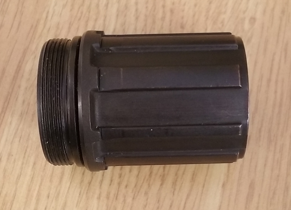

The complete freehub assembly:

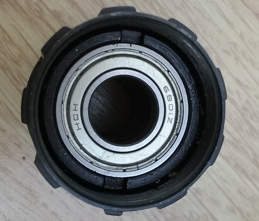

The freehub outer bearing:
The freehub inner bearing:
And here is the inner bearing housing with the bearing removed:
It looks like it should be possible to remove both of the bearings from the freehub without having to remove the stator assembly (or unscrew the freehub from the side cover).
If you just remove the R/H side cover (complete with the freehub unit) you should have adequate access to replace both the inner and outer bearings.
To remove the cover, undo the nine allen bolts holding the Right Hand side cover in place and place a piece of tape on the cover in line with the valve to make sure it goes back in the same position.
Place a block of wood against the end of the axle on the controller end and give it a nice firm tap with a large hammer of mallet to separate the R/H cover from the hub. it is usually sealed with a silicone sealant, and it may require a fair bit of force (several large taps) to break the bond between the cover and the hub assembly.
Once the bond has been broken, the cover should slide off the axle with a bit of persistent pulling and wiggling on the cover/freehub unit.
Take care not to loose any of the spacer shims (thin washers) that may be fitted on the end of the axle, as they can sometimes stick to the inside edge of the inner freehub bearing.
I suggest that you also cover the exposed stator and magnets with a clean cloth to prevent any unwanted metal particles from finding their way into the hub.  ;)
The old bearings will need to be drifted out of the freehub unit with a hammer and a suitable metal drift, but if you're really unlucky, they may have to be pulled out using a special slide hammer bearing puller:

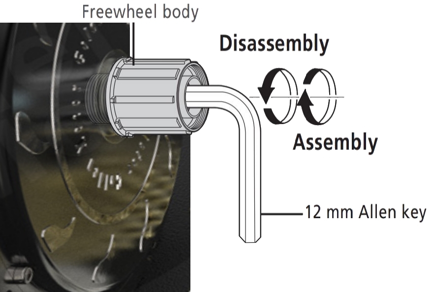

If the freehub unit did need to be removed for replacement, you would have to remove the stator assembly and L/H side cover from the other side of the wheel, and then refit the R/H side cover to allow the freehub to be removed with a suitable 12mm Allen Key:

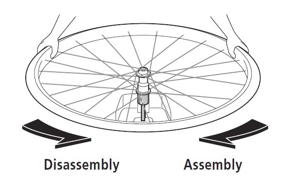

The allen key should be clamped securely in the jaws of a strong bench vice so that the entire wheel assembly can then be turned by hand to unscrew the wheel from the freehub unit:
If you need any further information or assistance, please don't be afraid to ask.
