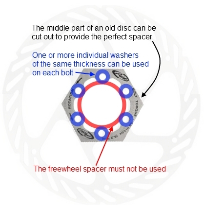

If the caliper would clear the motor's side cover by moving it out by ~1mm or so, you may be able to still use it by placing identical washers between the disc and the disc mounting (on each of the bolts) to space the disc further away from the cover.
« Last Edit: July 02, 2017, 04:51:00 PM by Bikemad »
