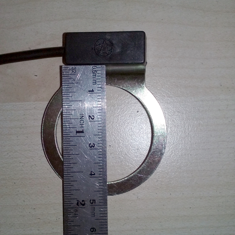

Tom, when you say "put the sensor on the other side of the bracket", do you mean on the chainwheel side like this:
There appears to be about 7mm of clearance between the mounting hole and the sensor body:

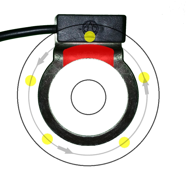

As long as the outside diameter of your frame's bottom bracket is less than 48mm, you might be able to file (or grind) away the portion of the bracket that is preventing the bracket from seating correctly on the frame, as indicated in red below:
If you are reasonably good working with metal (and have access to a hammer and decent vice) it might be possible to remove the sensor from the bracket, flatten the bracket out, scribe a line along the outer edge of the sensor and the outside diameter of the bottom bracket and then rebend it just outside the lines with a much tighter angle which should then fit perfectly.
If you are not overly fussy about your frame, you should be able to radius the edge of the bottom bracket with a file to accommodate the bend in the bracket. if the sensor is mounted below the bottom of the frame, the filed edge would not be seen.  ;)
I don't know whether the magnets are supposed to pass along the centre of the sensor, but I have also shown where the magnets are positioned in relation to my sensor.

On both of my sensors, the metal bracket moves the sensor back towards the centre line of the frame and further away from the magnet ring, but the different style of sensors are mounted on different sides of the bracket:

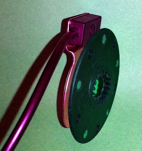

From your description, it sounds like your sensor is similar to this one:
If the bracket can be rotated and the sensor still fixes in the same orientation (without having to physically invert it) then it might work, provided there is still enough room between the sensor and the crank for the magnet ring to fit without rubbing against the sensor.
The direction arrows on the magnet ring are basically there to ensure that the magnets move across the sensor in the correct direction, otherwise the pedelec might not work unless you pedal backwards. ::)
