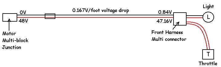

The additional load causes a greater voltage drop throughout the entire feed and return circuit consisting of two thin wires (battery + and battery -) that start at the sealed multi-junction block by the motor and runs right through the harness to the multi-connector on the front harness (over 5' on my harness). From the front multi-connector, the battery feed continues up to the light switch and then back again (that's another 2' each way) before heading off to the light connections (another foot). The ground wire from the light connection then completes the circuit back to the multi-connector (another foot).
So (excluding the thicker wires on the light unit itself) the current has to travel along at least 18' of thin gauge wire, and if the difference between the measured battery voltage and the measured voltage across the two light connections was 3V (48V at battery but only 45V at the headlamp) this would equate to a 0.167V drop across each foot of wire.
The throttle Hall sensor also shares the same ground connection in the front multi-connector, which due to the voltage drop along the 5' long ground wire has been increased to 0.84V instead of 0V.
So instead of the throttle signal being ~1V, the same ~1V output has actually been increased by 0.84V in relation to the battery ground, which the controller is directly connected to though the thick battery cables.
Therefore the controller effectively receives a 1.84V throttle signal voltage (~1V + 0.84V) which is equivalent to ~30% throttle.

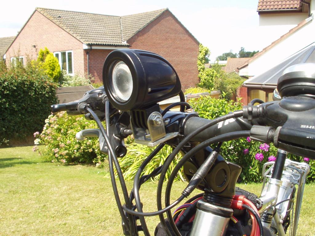

I have a 10 watt LED headlamp wired directly to the lighting wires on my Smart Pie 4 and did not experience a problem with that bike with the lights turned on, so yours might work OK too.
