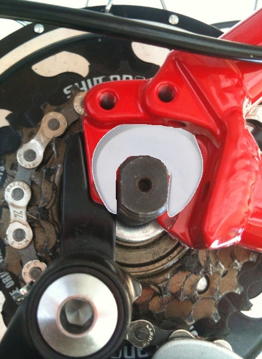

Your photos show the dropout plates to be surrounded by chassis tubes, forming a recess.  I would try shaping some steel? to fit the exact shape of the recess, but long enough to form a properly deep enough dropout for the GM axle and washer to fully support the nut.  I would epoxy the plates in position to make them effectively act as a torque arm.
I put the question mark behind the steel, as I don't know how much thread you have left on the axle.  If you had lots of open thread, you could use Alloy in a thicker section.
Re: Did I pick the wrong bike?
« Reply #3 on: April 02, 2015, 06:00:31 PM »
I scribbled in some green to show the shape I suggested.  Alternatively, If you have access to welding equipment, the yellow section could be bolted to the chassis for torque reaction.
