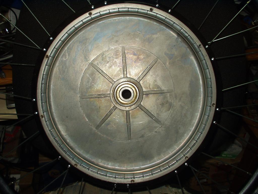

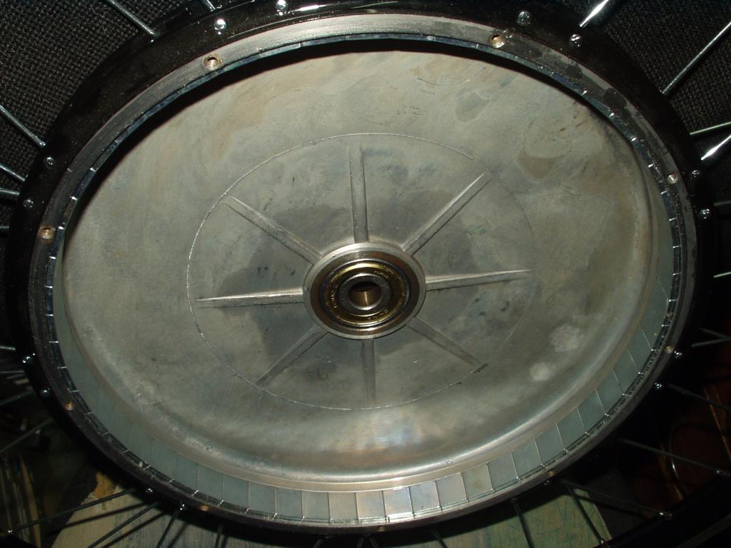

« Reply #6 on: February 08, 2015, 04:51:46 PM »
Got it open! I made a puller thing with hose clamps and wood that popped the cover right off. It doesn't seem to be the bearings. It appears that the stator is actually rubbing on one of the magnets. See attached images. I guess I could use the dremel and grind off part of the naughty magnet?

Zack, as it was only catching in one position, there must be a high spot on the stator which is catching the lowest magnet.
It would be better to use a file to remove the high spot from the stator rather than grinding the fragile neodymium magnets, but make sure you keep the magnets well away from the stator until all of the filings have been thoroughly removed.
After you have filed down the high spot on the stator, make sure that you apply a protective coating of paint or perhaps apply some grease to the exposed surface of the metal to prevent it from rusting.
There appear to be obvious chips on several of the magnets and the broken particles will probably be stuck somewhere around the magnets. Make sure you remove all of these particles before you attempt to reassemble the motor assembly.
It also looks like one of the magnets may have moved slightly, in which case it is probably no longer bonded to the motor ring but is simply held in place by its own magnetism.
I would run some very thin CyanoAcrylate glue into the joint between the magnets to ensure it stays in place during use, and I would also suggest coating any visible chips on the magnets with glue to seal and protect the exposed areas.
Before you apply any glue you should remove the other side cover first to prevent it from being glued to the motor ring and allow the glue to dry completely before refitting the cover.
The thin CyanoAcrylate glue is also very handy for repairing separated laminations on the stator. I use a pair of mole grips to gently squeeze the laminations back together and then run some glue across the outer surface of the stator laminations.
The thin glue will very easily find its way between the laminations where it will soon dry, bonding them securely together.

« Reply #8 on: February 09, 2015, 07:45:36 PM »
Thanks for all the tips, Alan. It looks like the "loose" magnet you mentioned isn't actually loose, but wasn't glued down flush with the others. It feels notably raised compared to the other magnets when I run my finger across them. Since I see scuff marks on multiple places around the stator (and around the bad magnet), I think I should try removing, cleaning, and regluing that single magnet. I assume nail polish remover will work to clean the magnet after I pop it out with a hobby knife. Then I have some CyanoAcrylate glue on the way to put it back. Will be repairing a few separated laminations with it as well.
I will give the magnet ring a good cleaning before everything goes back together. I don't see much in terms of debris from chipped magnets inside. It looks like they assembled it with many already chipped magnets. There are visible chips on the other side of the magnets too - that face away from the stator. I don't imagine it hurts performance very much, but is this typical?

I don't recall seeing magnets with chips on both sides and this is what my own MP4 magnets look like:
I'm wondering whether the magnet that is standing proud has been glued on top of magnet fragments. If so, I'm not sure how easy it will be to remove the magnet without further damaging it, as might break if you try to lever it while it is still firmly bonded to the hub casting.
It presumably didn't make any noises when new so either something has moved or the bearings must have more movement in them now than they had from new.
If it were mine, I would leave the magnet undisturbed (but make sure it is glued in place properly and simply remove enough of the stator to provide the required clearance.
If you have never used thin CyanoAcrylate glue before you need to be very careful not to apply too much. It is extremely thin and the capillary action will cause it to travel a long way (and end up somewhere you don't want it) and it really does bond skin tissue in seconds!
If you need to fill a large gap between magnets etc. I use sprinkle baking powder into the gap and wipe away any surplus before applying the glue. The thin glue quickly soaks straight into the powder and then it sets incredibly hard.
