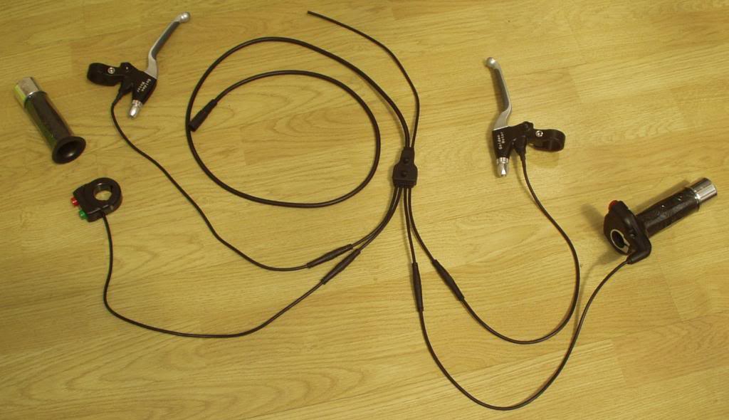

There are other DIY methods of converting the hydraulic levers including micro switches, reed switches and hall sensors, but using hall sensors would require three wires instead of just two for the additional 5V supply which the GM brake switches don't use.
The GM levers are meant for cable brakes and use a very simply push to break switch which is pushed open when the brake lever is released and closes the circuit when brakes are applied:
