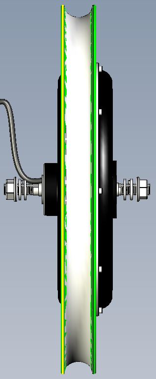

I am thinking about getting a 20" wheel for the front (the new Vector MP4). I'm curious about the proper dish--the Chinese seem to be ignorant of properly centering the rim between the frame stays of the hub on the lace-up wheels. Obviously this malady can be corrected by flipping the spoke heads around but with a molded wheel you get what it is....

Re: Monkeys bike with 'tassles'
« Reply #79 on: August 13, 2014, 11:40:27 PM »
If they followed my advice (which they said they were going to do) the 20" front wheel should be centred correctly, but I haven't tried one to find out exactly how well the centring of the 20" cast rim turned out. I don't know whether the 16" rim was changed or whether the offset is still as far out as the original.
« Reply #81 on: August 14, 2014, 12:50:13 PM »
I have just been looking at the solidworks drawing of the 20" MPII and the rim does appear to be nicely centred on the axle:
 So hopefully the MPIII (and MP4) are correctly centred too.
