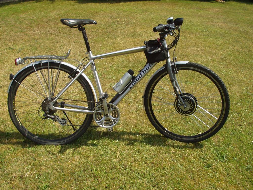

The Acceleration setting controls the response of the motor in relation to the throttle. At 100% the motor response is almost instant and can be a bit too jerky. Lowering the setting will produce a much smoother acceleration and should also extend the range. This setting will definitely need to be reduced if using a front motor in order to prevent wheelspin on loose or wet road surfaces.
Even with a large diameter 700c wheel equipped with the lower power Smart Pie 4 and a front mounted battery pack I had to reduce the acceleration to 80% to prevent wheelspin on loose surfaces.
The above "Wheelie Machine" has a rear mounted MP4, but I the acceleration setting had to be reduced to 70% before I could pull away on hills without the front wheel jumping off the ground, and that's with a mid mounted 29.6V battery pack.
I think I would really struggle to keep the front wheel in contact with the ground if I had a large 48V battery hanging out over the back wheel. ;D
