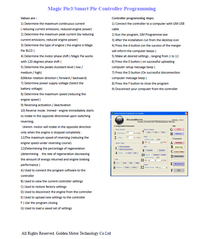

So far my only peeve is that the level of regenerative braking is too high on this small 20 inch wheel. It is really jerky and abrupt when braking at a slow speed.
I did a lot of reading in this forum, and watched Gary's Youtube video on programming the controller. Before I rush off to buy the USB cable PI-200E:
(1) Is there a written "how to" guide?
(2) After pressing "Connect" button, should I press "Get config" button to load the configuration of my controller first, before making any changes?
(3) I believe the only parameter I need to change is "Brake (Regen Brake)", then press "Store/Save"?
(4) I know I probably have to test myself to see what level of regenerative braking is best for me. However, does anyone own a 20 incher and has made changes to the regen braking level to give me some tips?

Sorry to hear of the missing screws. Please create a ticket at www.goldenmotor.ca/ticket and Ill get some out to you.
I recently stumbled upon this instruction sheet for MP3/SMP and I would assume BAC controller programming.
Can anyone read this or is it too small?

I found the user manual in PDF inside the zip of the programming software download. I also found some bits and pieces of information related to settings (eg. how many amps) in the forum. I only intend to reduc the regenerative braking level, that's all.
Don't worry about the screws. I have the control box all taped up and mounted on the bike, I don't want to unmount and mount everything again.
