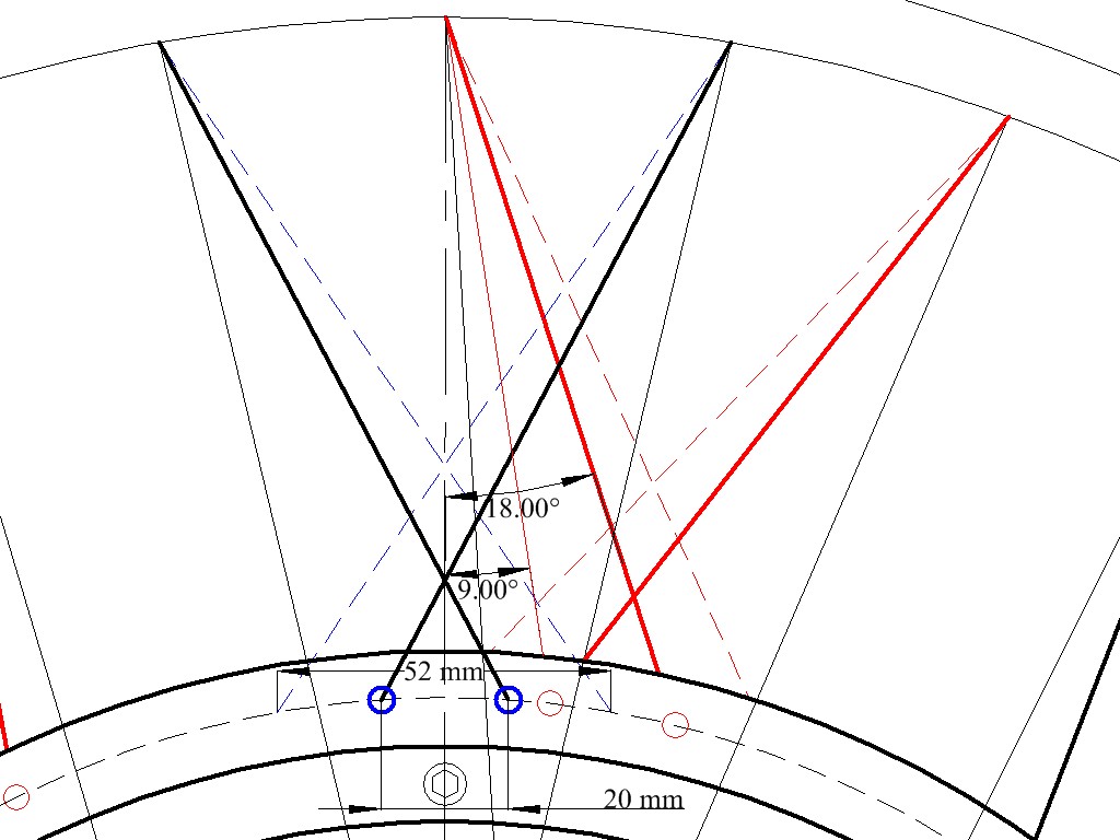

I just received my new spokes from GM but I found out at the are 140mm and the original are 115mm... Mmmm I can not understand how thas is possible. How ever I am trying to see if I could use the 140mm and they seems that fit ok when I cross them (see pic.)
does any one know about this way of set up?? is ok or not??

I presume you have the 26" rim and you mean to cross the spokes like this:
In which case 140mm is going to be much too long as the dotted lines in the picture indicate where the 130mm spokes were fitted on the original MKI Pies. The excessive angle between the spoke and the rim will also cause the spokes to be curved rather than straight.
It might be possible to file the holes in the rim at the same angle as the spoke to ease the bending force, but I still feel that those spokes will be too long.
