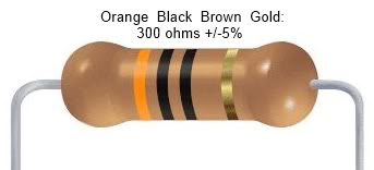

Finally got around to replace the defective internal controller with one that I purchased from Gary at GM Canada (thanks Gary). It seems like one of the resistors just blew up. I would like to get this one fixed/repaired to have as a backup in case my current one suffers a similar fate. Does any one know which resistor should I buy, the lines on the middle are burnt and I cant make what colors they where before.
I hope that by replacing the resistor I can get this controller to connect to the PC.

« Reply #10 on: May 05, 2012, 01:32:44 PM »
I couldn't make out the colours, so I asked my son to check the colours for me and he said they were Orange, Black, Brown and Gold:
It also measures 298 ohms with my meter, so he's evidently not colour blind like me. ;)
Without knowing what actually caused it to blow in the first place, a new resistor will probably blow just like the old one did. :(
I would say there is a problem elsewhere on the controller that is causing excessive current to flow through this resistor.

Thanks Bikemad. I will have to investigate what else might be blowing the resistor.
