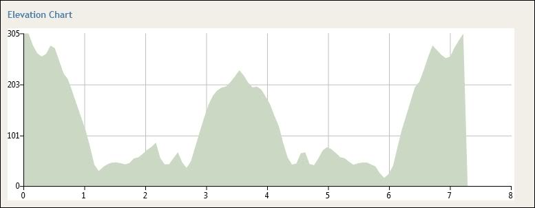

I'm wanting to get a MP for commuting to work instead of a car.  I'm getting a bit old but refuse to let in and buy a car - for one reason I'm not sure whether I can afford one!  Some days I want to cycle assist some days I want just sit and pretend to cycle.  I want to fit it onto my mountain bike which currently has hydraulic disc brakes front and back.  I've included an elevation of my trip to work.  My trip back is the same in reverse.  I'm fairly skinny and weight about 70Kg (11 Stones).  Some days I want to barely peddle at all (bits of my body are giving up :).

Not wishing to rain on your parade, but I think your biggest problem is the UK power limitation for electric bikes. As per http://en.wikipedia.org/wiki/Electric_bicycle_laws the legal limit in the UK is a somewhat anemic 200 watts. I believe  the MP motors' lowest rating is 500W at 24V. If you're like me however, you'll be ignoring the local legal limit (is this posting traceable?).
Your chart seems to indicate relatively large changes in elevation. Whether this is due to the compression of the graph I'm not sure. If in fact your route takes you through extreme elevation changes, you might consider a completely different type of electrical assist. At the risk of raising a chit-storm of protest, you might consider turning away from hub motors toward mid-drives.
As you are probably aware, mid-drives combine your pedal power plus the motor's power through a common jackshaft arrangement, and from there on to the rear gear cluster. This allows the motor to be run at a more efficient speed (and therefore with greater power) on those particularly steep and slow sections of your ride. Granted, mid drives are a somewhat more complex animal, but the benefits in your case may warrant such an approach.
Having said that, I went with the hub drive for a couple of reasons. One is that I don't live in an area with many hills (south central Ontario Canada) and two, because hub motors are considerably quieter than mid-drives. It's difficult to get away from the chatter that the necessary extra gearing makes with mid-drives.
Good luck in your quest...
By the way, how did you generate that elevation chart?

« Reply #5 on: May 08, 2012, 01:54:02 PM »
I've just entered the return trip details for one of my local trips into http://bikeroutetoaster.com and this is the result:
When my modified MKI Pie was still alive and drawing up to 60 Amps, I could manage this route by using ~80% capacity of my 51.8V 5Ah LiPo pack, although the battery warning device did indicate a low battery voltage under load on the last steep part of the trip.  On a 25.9V 10Ah LiPo pack I can manage this route using less than 30% of the pack's capacity.
Climbing steep hills will suck the power from the battery pack fairly rapidly, but at least they also allow the regen to help put some capacity back into it again when you're going down them.

Hi andto the forum Neill, my main concern for your intended use is the range you're likely to get without pedalling with all those hills. If you can recharge the pack while you are at work, you should be able to manage with a 48V 10Ah pack.
If you are not able to recharge at work, you may have to consider using a lower voltage pack with a higher capacity.
