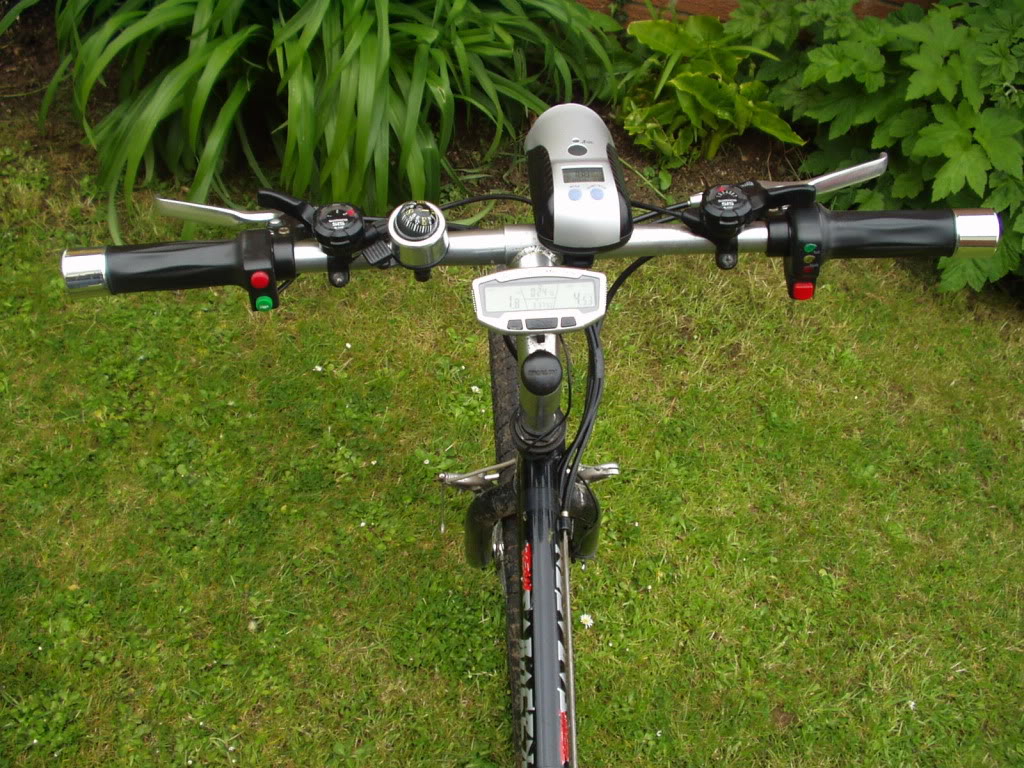

A twist throttle will be far more natural to use and the installation looks neater too, but it can be a problem to install if you also have a twist type gear-change mechanism. One disadvantage with the twist throttle is the chrome end caps that stick out on each side actually increase the width of the handlebars by about 2 inches, which can be a pain when negotiating narrow openings, or squeezing between two lanes of traffic waiting for the lights to change.

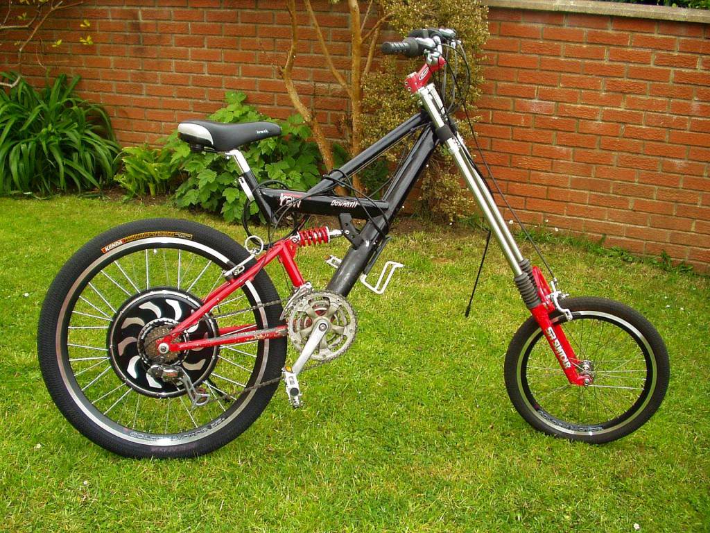

I have a twist throttle with lever operated gears on my main bike:
I had to install a thumb throttle on my MPIII powered chopper style bike:
although I really would have preferred to use a twist throttle, but unfortunately it has the original twist type gear-changers . ::)
