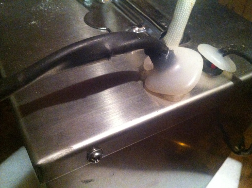

This time I open up a Golden Motor 48V30AH LiFePO4 Battery. I'll let the photos tell the story.

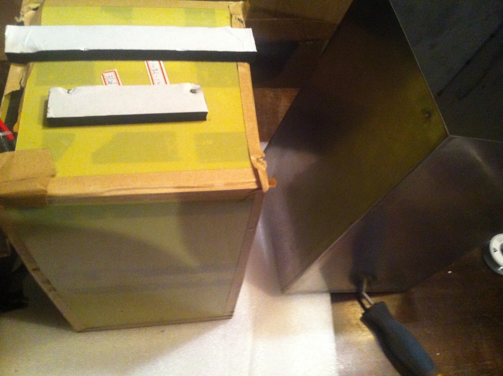

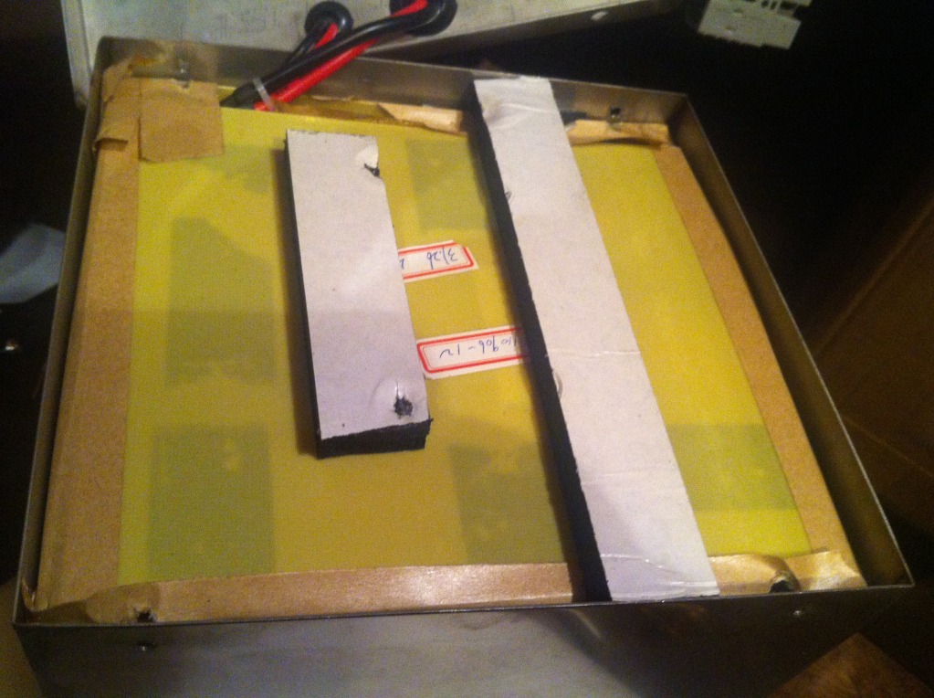

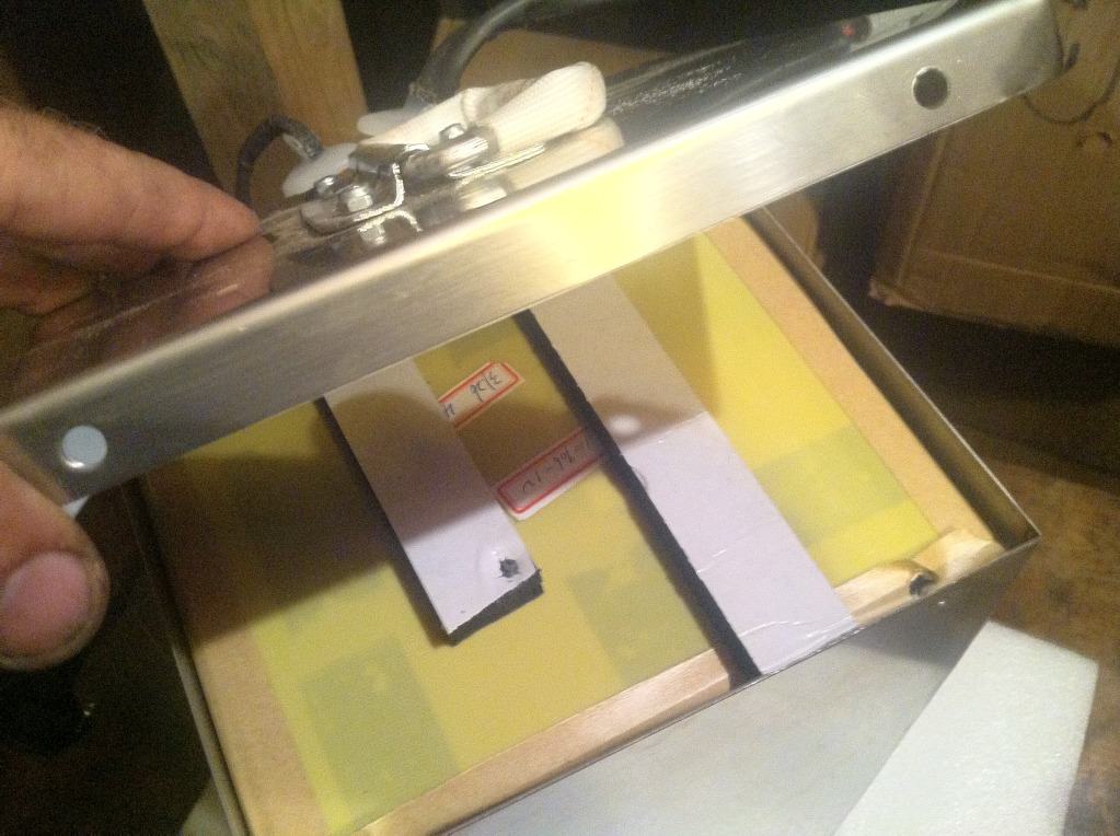

The cells are packaged in a hard plastic enclosure with tape holding it together

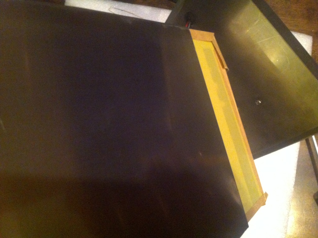

Now that the top is open I turn the case upside down and slide out the battery.

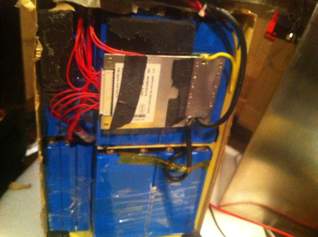

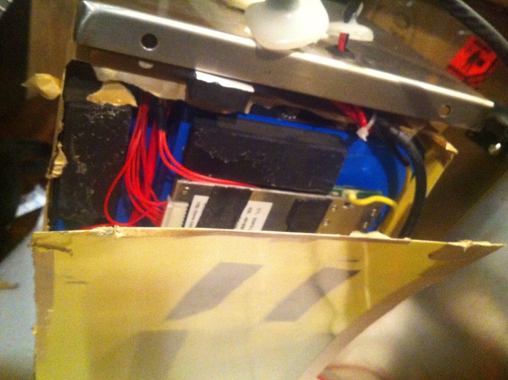

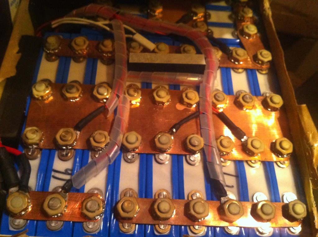

I open the top and here are the cells. It looks like they are all hooked togeter in sets of three with one lead to the bms for each set.

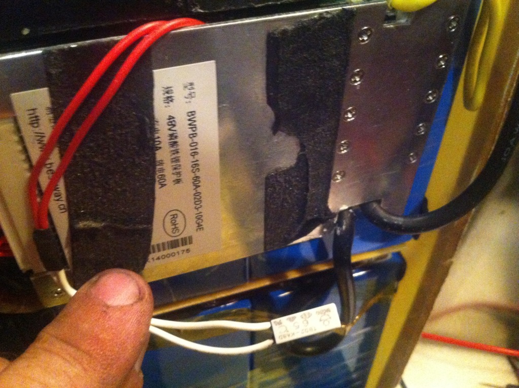

Peel open the front and there is the 60 amp BMS.
Looks like this BMS has a heat sensor probe as well.
