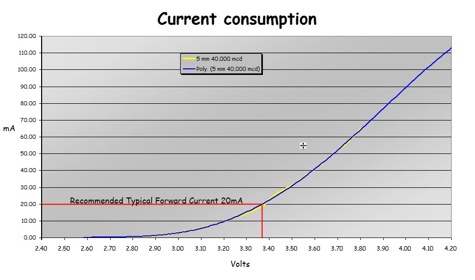

Unfortunately, an LED's current increases greatly as the voltage rises over and above the typical forward voltage across the LED.
Here's a graph showing the results of voltage variation on a 5mm 40,000mcd white led that I tested a few years ago:
If you look at the curve you can see just how quickly the current starts to rise as the voltage exceeds the point where the recommended typical forward current is achieved.
I only tested the LED up to its 3.8V maximum rated voltage, but if I had carried on to 4.1 volts it would actually have been drawing more than 5x the recommended typical current!
The driver circuit incorporated into your torch not only controls the different lighting modes (low, High, Flashing etc.) but it also regulates the current going to the emitter (LED). This ensures it doesn't suddenly change from a very bright LED into a useless DED (Dark Emitting Diode). ;D
