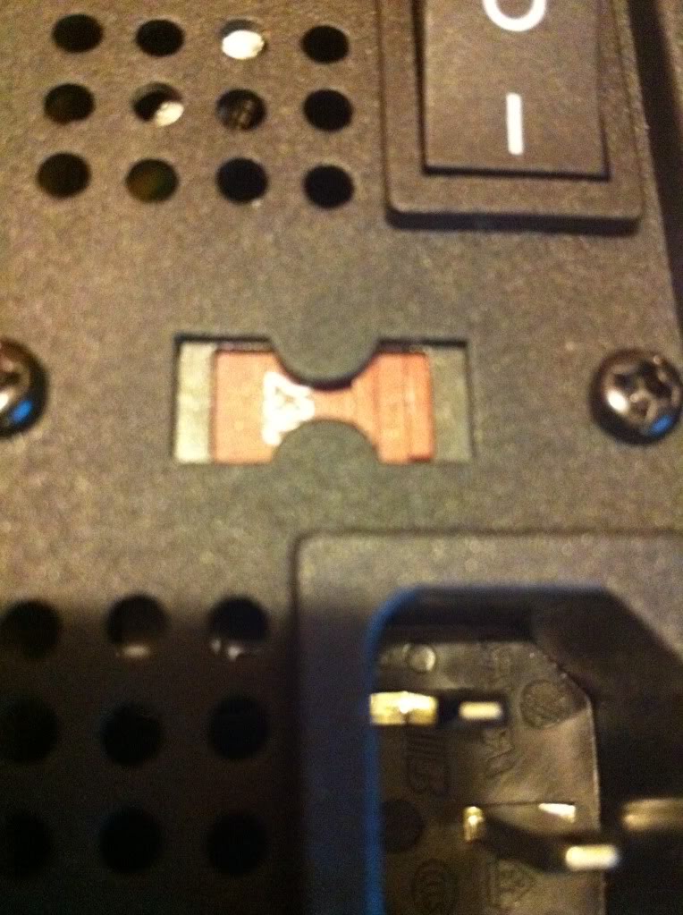

If nothing is lighting up on the charger, it's more likely to be a fault with the charger rather than the battery. If your charger has a voltage selector switch, please ensure it is set to the correct voltage for your country (115V or 230V).
If your charger is equipped with a fuse, check the fuse to see if it has blown and replace it if necessary.

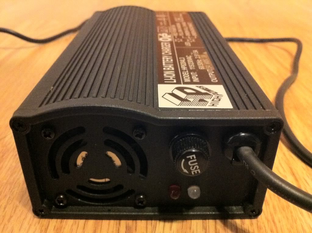

WOW yours has a fan
The charger they sent looks totaly differnt from what you recived, what was sent to me has no switch, no fuse, looks more to what you might have on a laptop computer, as its sealed and has basically no way of peeking inside without destroying the molded plastic casing, lights up ok and shows a what im assuming is a charge, I need to find someone that has a multi meter to see that a charge is coming out of the battery.

I have a 36v charger and a 48. The 48 does have a fan n fuse, but the 36 is just basic 'like a laptop charger' so I guess the 24 will be the same.    Are you sure your adapter plug is capable of carrying the amps/current? It most probably is, but just a thought. I just cut off the two pin plug that comes with the charger and put a U.K 3 pin on instead.
