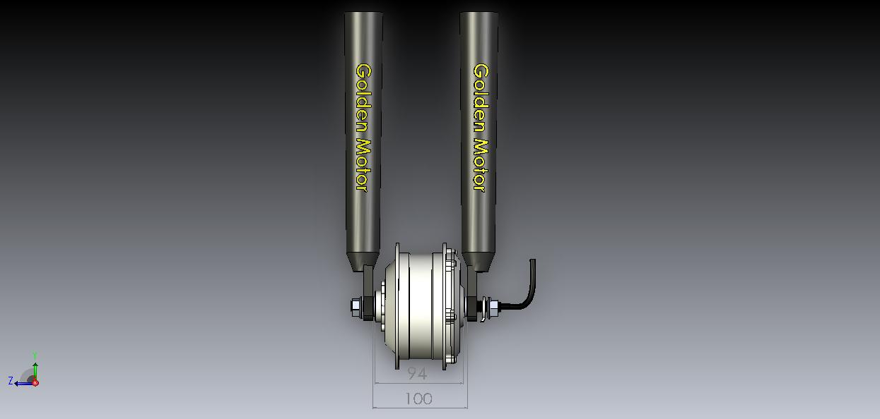

Hmm doesn't sound like the nut should be on the inside of the fork. Does your setup look like this?
If anything, there should be a washer on the inside of the fork if you had some spacing issues. And I assume you did not install this motor initially? I hope the nut hasn't caused damage over time, and if it is the bearing it's a fairly straight forward fix so don't fret there :)

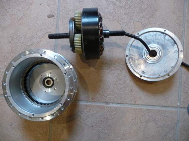

Phil, 5-8mm sounds like a lot of movement, and I'm guessing it could be a collapsed bearing. If the bearings themselves are not badly worn, they may be loose enough on the axle (or loose inside the housing) to produce some sideways movement at the rim.
Is the movement more noticeable at one side of the hub compared to the other?
There are different types of mini motors, but I'm not sure whether all versions have the different sized bearings that can be seen in this photo:
