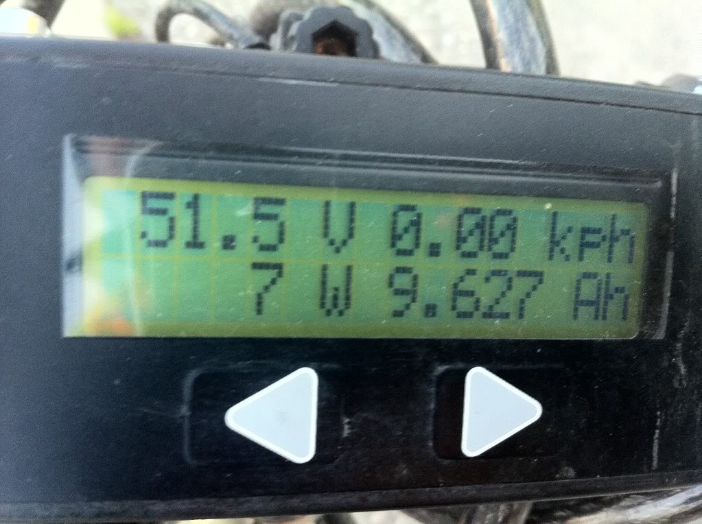

48v10ah lifePO4 gets 9.627 AH used before the bms kicks it out

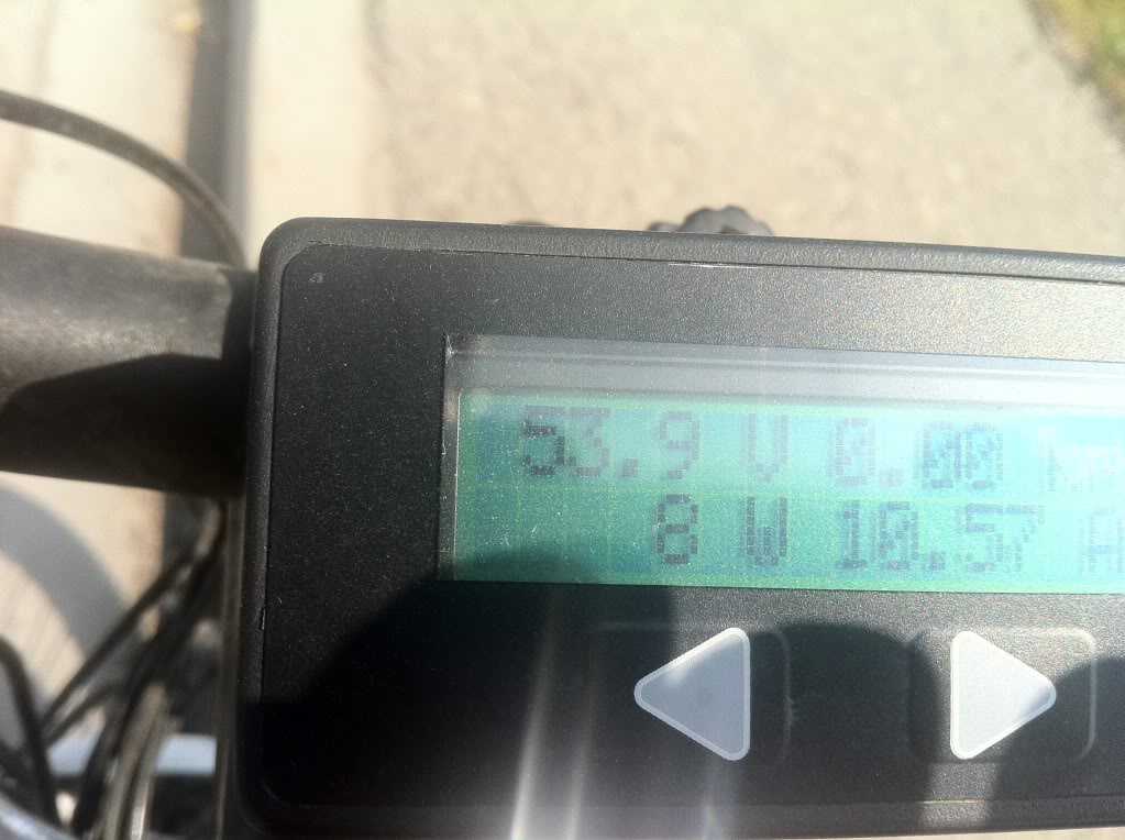

48v12ah lithium gets 10.57 AH used before the bms kicks it out

Looks like a tough call. So what exactly does this data mean? Correct me if I'm wrong but what I see is:
The lifePO4 was able to use the most of its capacity, and because of the slightly lower voltage (51.5V vs 53.9V) drew less juice overall. Or is this just because the lithium battery has been used more?
Both batteries felt the same you said, but did you happen to notice top speeds?
My guess is the lifePO4 will be the most consistent in the long run. Is the max/continuous discharge rate greater than the lithium?
Re: GM Lithium 48V 12AH vs GM LifePO4 48V 10AH
« Reply #6 on: June 21, 2011, 03:07:43 PM »
Whoops I should have mentioned ignore the voltage and only read the amps used. The voltage shown is after the battery kicked out I hooked it up to another so I could read the amps used. So the volts are from a second battery I had with me.
