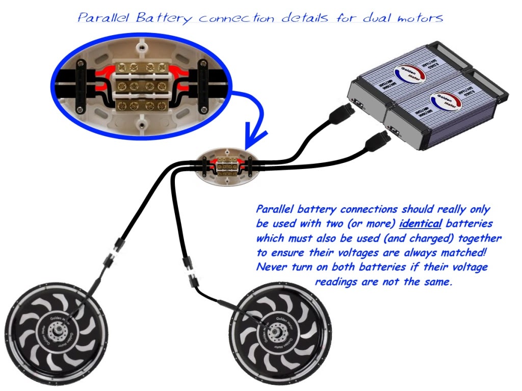

The following diagram should help to clarify the difference between series and parallel configurations:
Wiring two identical batteries in series will double the voltage but will still have the same capacity (Ah).
Wiring two identical batteries in parallel will double the capacity (Ah) but will still have the same voltage.
You can connect identical voltage packs of different capacity in parallel, but only if they are the exact same voltage and chemistry. So it's not a good idea to put a 36V LiFePO4 pack in parallel with a 36V Li4Mn2 pack because their actual voltages will be slightly different.
Before you connect battery packs in parallel, you must make sure that they are both charged to the same voltage.
As your bike has different motors and separate throttles, it might be better to simply connect one battery to each motor.  This way, if one battery goes flat, the other one can still be used to get you home.

@Bikemad can you con figure for two batteries?  PLEASE?  THANKS.  IN PARALLEL. PLEASE.
« Last Edit: May 15, 2012, 12:55:28 AM by Bikemad »
Re: Two Batteries In Parallel
« Reply #6 on: May 15, 2012, 01:43:54 AM »
This should make it nice and clear:

Make sure all batteries are fully charged and balanced before hooking them up in parallel.
.5v/.001 ohms =500 amps
A .5v potential difference between two batteries along a thick conductor could cause a lot of damage.
