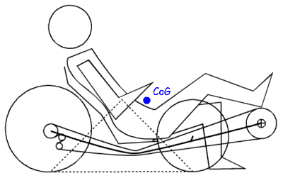

or maybe I'll get a tadpole trike this time and have to figure out how to get two motors running off of one throttle.
Running two motors from one throttle is reasonably straightforward, attaching the hubmotors using a single point axle fixing might be more of a challenge though. ;)
Twin regen with a forward C of G might not be such a good idea, the weight of a rear motor would help to move the C of G back a bit and keep the rear end in contact with the road:
