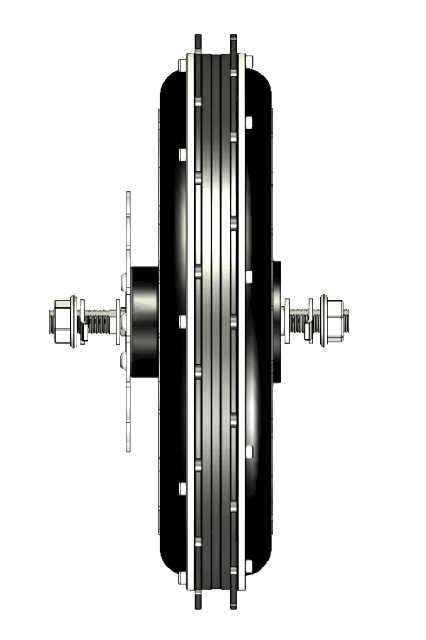

If that was because of the switches on the levers the same would apply to both.  I think it has more to do with the thickness of some hub motors. A wider hub fitted between the narrower front dropouts may not leave enough room for the disc to fit in its correct place and still have enough clearance between the disc and the hub for the caliper to fit correctly.
As Muzza has already mentioned, this is not a problem for the Magic Pie with most cable operated calipers, but it could be for some of the bulkier calipers and probably dual piston hydraulic ones too.
The following pictures shows a front Magic Pie with the disc brake fitted:
The narrow width of the Magic Pie makes this option possible.
