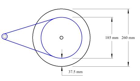

If you are planning on driving both rear wheels from a single pulley located centrally on the rear axle, please be aware that you will only have 37.5mm clearance between the pully and the road!

You say that the distance between the pulley and the road is 37 mm but I would say 260 - 185 = 75 mm::)
Tu dis que la distance entre la poulie et la route est de 37 mm mais je dirais plutôt 260 - 185 = 75 mm  ::)
I said:
Quote from: Bikemad
"If you are planning on driving both rear wheels from a single pulley located centrally on the rear axle, please be aware that you will only have 37.5mm clearance between the pully and the road!"
And this is why:
Hopefully we both agree on the correct clearance now. ;)

Hi
Yes sorry :-\  :D
