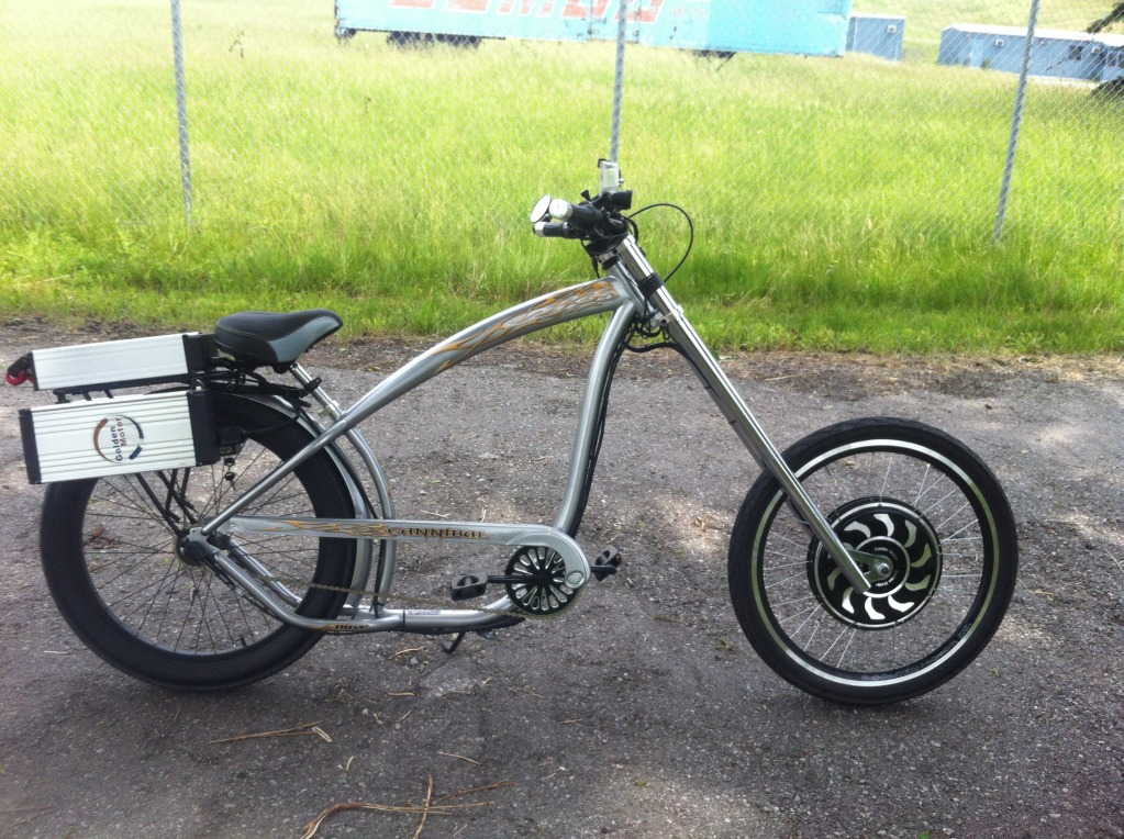

Hi Wilson, I am also into ebike and personally own a Magic Pie 5 Vector running with a huge 36v 10S12P battery (25lbs) on a seat rack made from recycled laptop batteries.  This make my bike top heavy and all the weight is in the rear. I have a background in mechanical engineering and have a 3D printer, so I am now building a new battery that is going to be mount under the down tube, so to have the lowest center of gravity possible. This will balance my bike perfectly as the rear hub motor is around 20lbs and my new battery will be around 14lbs. The new battery is a 10S9P made of the Panasonic/Sanyo NCR18650GA 3500mAh 10A 18650 cells. This pack will be 31Ah with a whooping 1134 Watts hour capacity. I expect my range to be around 150km - 200km + with some pedaling.
I can tell you that putting a 40lbs battery on the handle bar is going to be very top heavy for you.
Looking at your bike picture, you have plenty of room to mount your battery under the down tube.
I have attached picture of my current bike and also a sketch of my new battery design mounted on the down tube.
More info on my current battery design on this post:
http://goldenmotor.com/SMF/index.php?topic=6079.msg34081#msg34081
Good luck with your project
Cheers
Dan

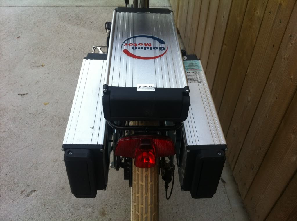

Higher battery capacity can easily be achieved by using multiple batteries wired in parallel:
This would also allow the bike to carry one, two or three batteries for short, medium and longer trips.
Three 36V 12Ah batteries in parallel would provide 36V 36Ah in total, which equates to a 20% increase in range over the single 36V 30Ah battery.  ;)
The 36V 30Ah battery mentioned in your previous post should be fine with the Magic Pie Edge as it can continuously supply more current than the Edge will draw under maximum load.
I suspect you may need to purchase a suitable Anderson Powerpole connector for the Edge's battery cable to allow it to plug straight into the battery's connector (which is probably a SB50A).
