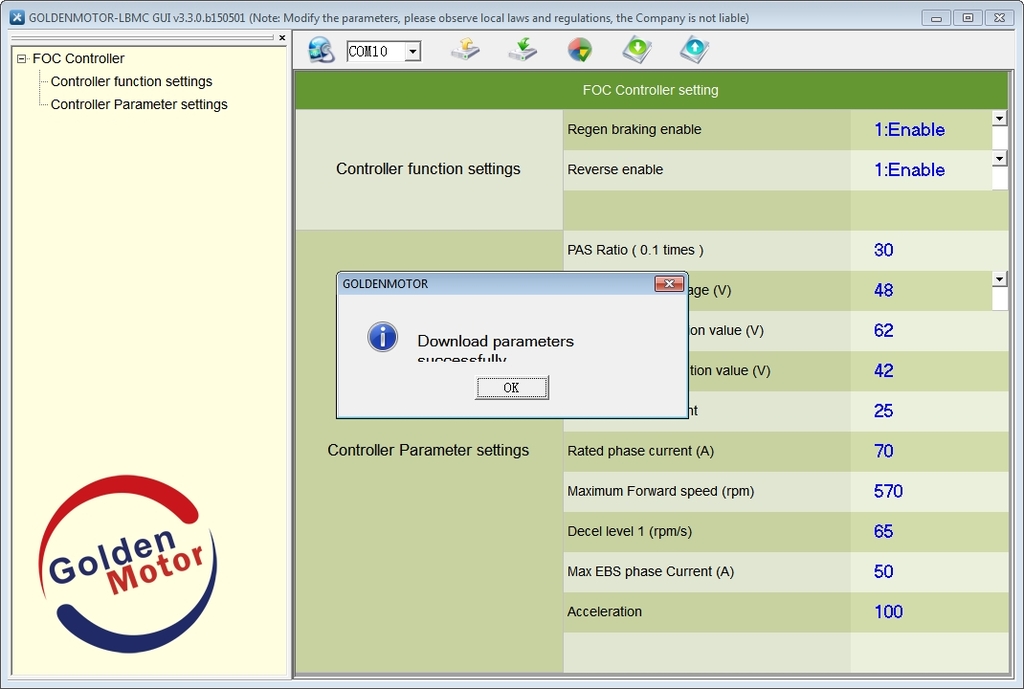

The first picture, is the original controller settings of the front wheel.
The second is the new controller settings of the rear wheel.
I have tried to change the settings in the two controllers and none is possible.
Thank you for your help and greetings,
Luis
Re: MP4 Setting controller
« Reply #3 on: January 06, 2017, 02:57:35 PM »
Hi Luis, when you click the "Download" icon to save the parameters to the controller, do you see the "Download parameters successfully" popup message box?
I think you may have a problem with the USB programing lead, as it obviously appears to be receiving data correctly from the controllers but seems to be having problems transmitting the new data back to them again.
« Last Edit: July 02, 2017, 10:09:08 PM by Bikemad »

« Reply #4 on: January 06, 2017, 03:25:20 PM »
Yes, I see the "Download parameters successfully" popup message box.
As you say, the problem must be in USB programing lead. so I will require a new one.
