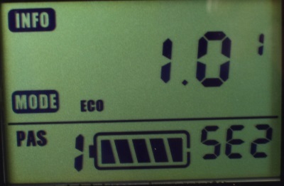

My early BAC-601 does have the "SE2 Wheel Diameter Adjusting Factor Setting" to adjust the accuracy of the wheel size:
Quote from: User's Guide
6.2.2 SE2.Wheel Diameter Adjusting Factor Setting
Setting the wheel diameter adjusting factor can obtain the accurate speed and
mileage value through "UP" and "DOWN" button.
The default setting is 1.00 and minimum is 0.7 and maximum is 1.3.
(Note:actual wheel diameter = wheel diameter X wheel diameter adjusting factor )
This should allow you to increase or decrease the distance and speed readings up to 30% in addition the the default wheel size setting. (More details can be found in the User's Guide.)
If your later Display unit does not have this adjustment, and the correct wheel size was definitely saved, you could try changing the setting to mph instead of km/h and select smaller wheel sizes until the speed and distance read correctly.
