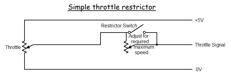

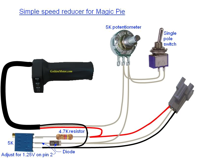

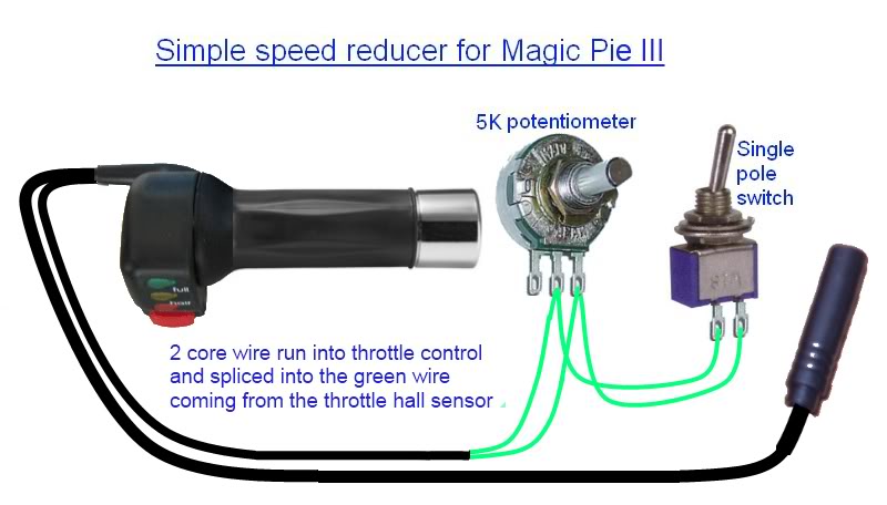

Dan, as the Vector controller still uses the same type of throttle, the speed reducer should work just the same as on the other Magic Pies:
The diode and resistors in the above diagrams were needed on the Earlier Pies to prevent the controller from beeping if the signal voltage dropped too low when the throttle was fully released.
The later controllers do not have a built in audible warning device (beeper) like the original internal controllers did.
I would therefore use the more basic MPIII circuit for MP4 and MP5 controllers:
You will need to identify which colour wire is used for the throttle signal wire to ensure that you connect the speed reducer in series with the correct wire.  ;)
