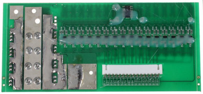

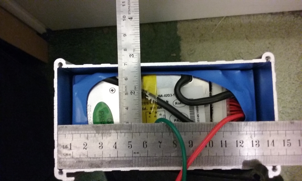

I have just had a look inside my GM battery and I'm pretty sure that BMS could be made to fit inside without too much hassle.
Here is my existing BMS in the end of the battery:
And here are the dimensions of the battery casing:
This is how the suggested BMS should fit, but you would need to file a slot at the edge of the board to allow the balance leads (and the red wire going to the charging connector) to fit between the BMS board and the battery casing:
The 16 pin socket could probably be bent up slightly away from the circuit board to allow a bit more clearance for the balance connector plug and wires, but I don't know whether the existing balance leads will be long enough to allow the connector to actually reach the socket.
It might even be possible to resolder the balance lead connector on the opposite side of the board to allow the balance wire connector plug to push straight in without the battery case getting in the way of the wires:
If it were my battery, I would definitely get that BMS to fit one way or another!  ;)
