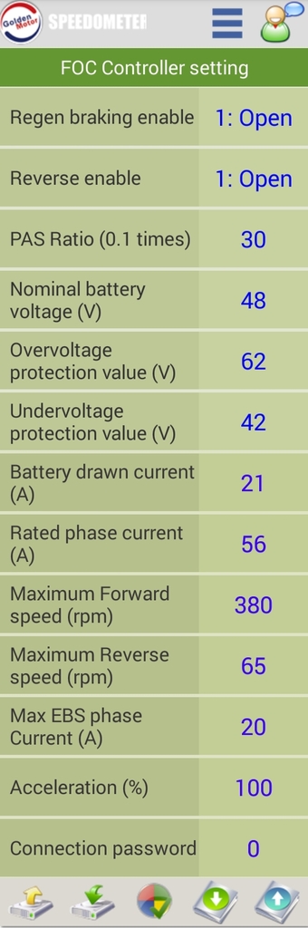

Hello everyone, first post here.
I'm contemplating the purchase of a Magic Pie V5 kit and was wondering what the factory (out of the box) settings are set to.  Screenshots would be very helpful.  Thank you.

Hi Woody andto the forum.
I don't have a Magic Pie 5 to check, but here are the default settings for the Magic Pie Edge controller:
And here are the default settings for the MP4 controller:
I would expect the MP5 settings to be the same as the MP4 shown above, as the only difference between the two is the Bluetooth connectivity.
