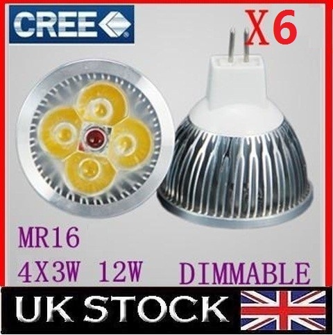

I once purchased some 12 Watt MR16 LEDs in the UK (which were probably made in China) and they each (supposedly) contained 4 x 3 Watt Cree LEDs:
I tested them on a 12V supply and although they seemed to be reasonably bright, they were definitely not the stated 750 lumens that I was expecting from these 4 x 3W Cree LEDs.
I therefore decided to measure the current and was very surprised to find that the whole unit was only drawing around 250mA @ 12V which meant I had effectively purchased 3W LEDs instead of the advertised 12W LEDs.
I suspect they were actually made up of 4 x 1 Watt LEDs but the electronic driver unit was only capable of delivering a maximum of 3W output, hence the 250mA current @ 12V.

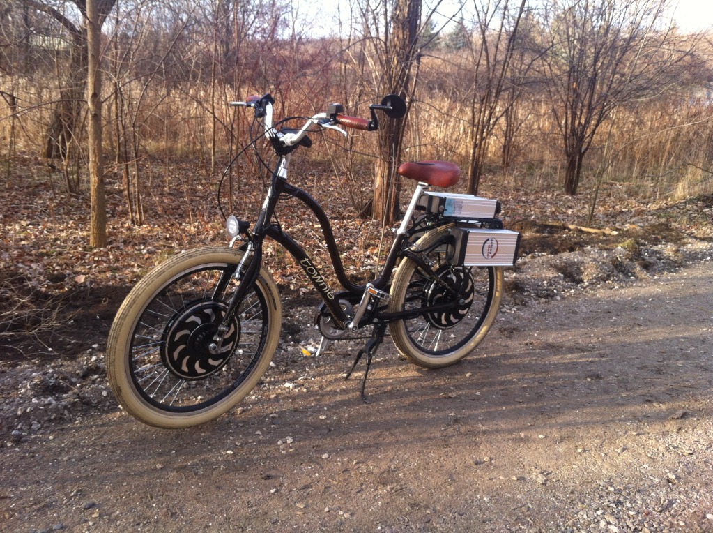

Offline Ecobully
  • Posts: 29
Re: 48v GM Battery in Bike Frame
« Reply #13 on: February 20, 2016, 06:27:20 AM »
Sourcing genuine cells has been made difficult with knockoffs. There are a few reputable resellers that cater to the needs of battery pack builders. LG/Samsung/Sanyo all seem to have some great high drain cells rated at 3500mah right now priced at around $5-6/cell. I guess Endless-Sphere threads has made it easy to find good sources (and bad ones, too).
A123 LifePO4 pouches and cans were once considered a hot commodity in the ebike world, but most have moved along and over to 18650 cells. The lightweight, and highly durable cells allow users to charge/discharge quickly and if they last 2-3 years, one can then enjoy newer technology that comes about which will probably yield even
I use LiFePO4 cells in my RV and enjoy it over my older SLAs. I also use Sony VT LiMn cells that have been bullet proof and in balance for the past 5 years without a BMS. I keep my LiPo packs and single cells in a bunker inside my fireplace--no fires, but I don't trust them while unsupervised. This type of uneasiness has not been extended to the newer 18650 cells (I use Panasonic/Sanyo 18650GA cells). Prices have dropped significantly and capacity along with C ratings have risen quite a bit with each coming year.
BTW, those older Headway 15A LiFePO4 cans were made into 4S10P banks for my RV and are doing quite well paired with my solar panels. They used to ride along behind me on my bike, but I moved onto lighter higher capacity packs.
I write this not to place a dark cloud over LiFePO4, but to offer different options and their respective pros/cons. If I were to sell these packs and carry liability for my advice, I may play it safe with IFR for the time being. Again, just another option
« Reply #14 on: February 20, 2016, 11:25:28 PM »
In re reading my last few posts it sounds like I am against new battery technologies. This is not true. I'm all for it. Believe me I consider getting into the new stuff on a daily basis. But at this time for me when it comes to warranty and liability issues its best to stick with the safer and longer lasting batteries at least for the time being. Getting double the lifespan for basically the same money makes sense to me and to a lot of my customers. At this point I still have trouble keeping batteries in stock even in the off season. In the past few months I have had a major rush on batteries and completely ran out. So a lot of people are still on board with lifepo4. Also the fact I have almost zero battery warranty issues to deal with is a big bonus for me and my customers.
