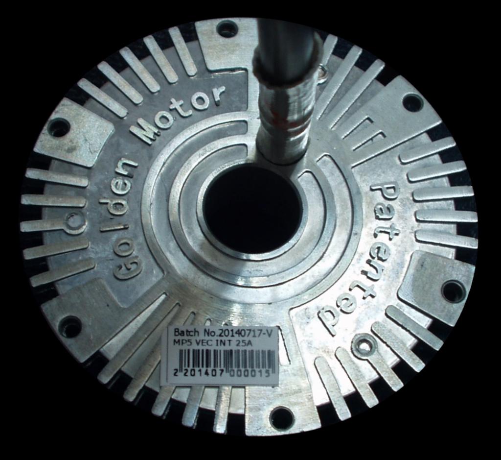

My dealer in Sweden said that PAS do not work. And I will get Replacement controller. When connecting the engine to the programming console is there any way to get info what version of controller I have?
Re: MP4 and PAS support?
« Reply #5 on: January 15, 2015, 07:24:40 PM »
Unfortunately, you cannot tell the controller version from the programming software. To determine which controller you have you will need to check the printed label that should be attached to the outer face of the controller:
If you're lucky, you may be able to read the details through the slots in the cooling fan/brake disc mounting unit.

Does the label says Mp5 ? on the picture A new version or?
« Reply #7 on: January 15, 2015, 09:19:15 PM »
Yes it does say MP5, but it is not a new version. The MP4 was originally named MP5 during development, but this was later changed to MP4 instead. I seem to recall that the number "4" is unlucky in China, and this was why they were reluctant to use it in the first place.
The controller shown in my last post is an original pre-production sample vector controller that I struggled to fit into an early MPIII, but after a lot of work, it was quickly removed again because it would not function correctly on the MPIII. :(
