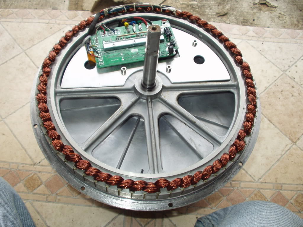

hey Bikemad any idea the temp rating of the magnet wire or better yet the temp at melt down
Laurence
Re: vec300
« Reply #6 on: November 07, 2014, 12:46:54 PM »
Although I have pushed some reasonably high Amps into my Pie it has never been subjected to sustained high current for a long enough period of time to cause overheating of the windings, demagnetising of the magnets, or Hall sensor failure:
Unfortunately, I have no idea what the maximum rated temperature is for the GM copper wire used for the stator windings:
